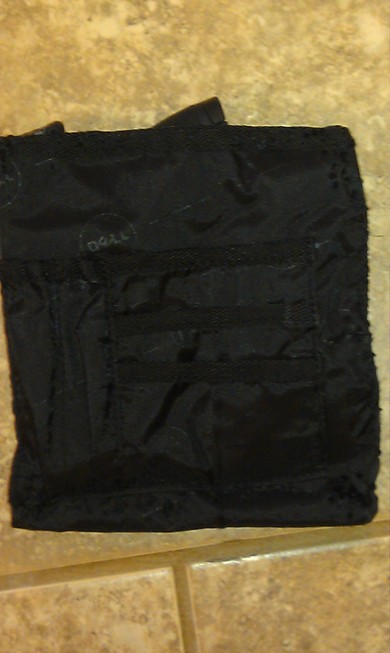

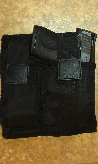

I just joined the forum and I wanted to make an IWB holster out of materials I had at my house. Looked around and I used my Dell Laptop case to do it.
It is not the prettiest but it is very functional and comfortable. Place for pistol, extra mag, and ID cards.
