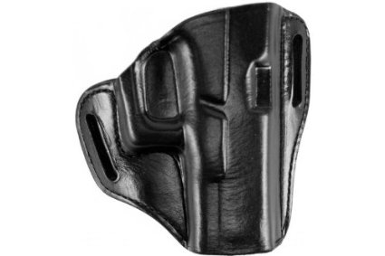

Im getting a new Bianchi 57 Remedy Holster Fits Glock 19, 23 tomorrow. In the reviews some one said they had to oil the inside of the holster.
Is this something I need to do? Thanks.
What Oil do I use???? :headscratch

Thanks everyone. I got the holster today. The manufacture (Bianchi) instructions said to use silicone spray on the inside & plastic bag over the gun when holstering unloaded gun.
Leave it overnight then that's all to break in the holster. I just used a little silicone (Very little). as the holster wear a little it will be fine.
Clean the holster with mild dish soap.

Nice looking holster Pecos.. I have one that looks the same but a different brand "Tagua" i can carry my and 1911 in the same holster :txflag:

Thanks. I also have a Tagua left handed belt slide holster for my G22/17. It didn't need breaking in the inside is lined with suade or something. It's a great holster!!!! :thumbs2:
