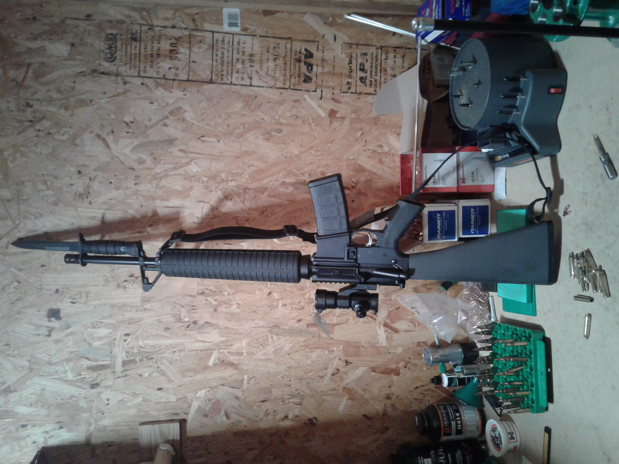

Anderson lower, PSA 20" upper, 1/7 twist
Anderson lower, PSA 20" upper, 1/7 twist, very accurate with 62gr handloads
