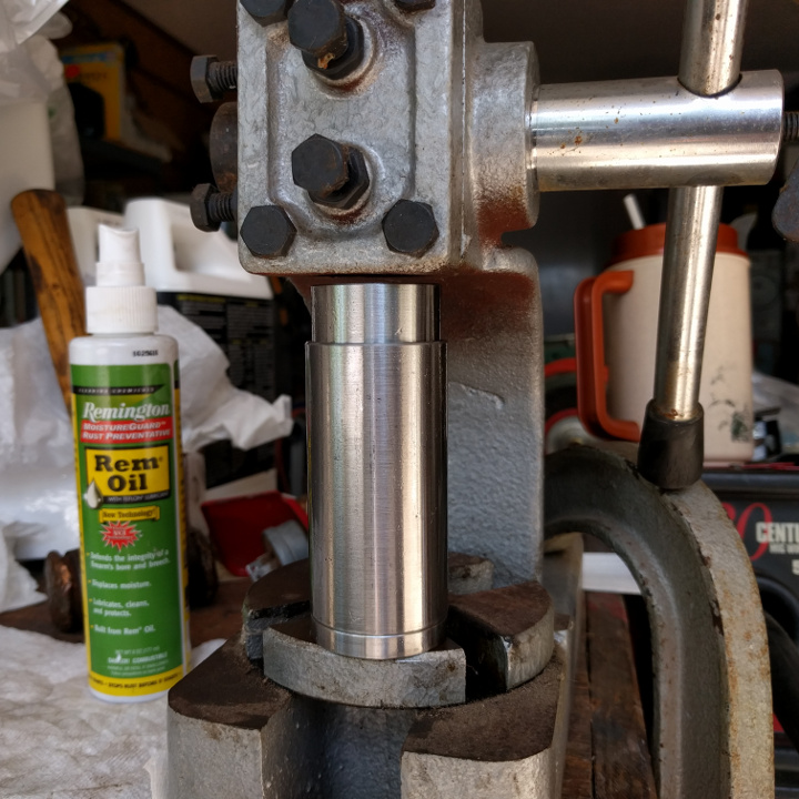

But, I have received most of the parts I'll need, and today I picked up a couple dozen expansion plugs. I didn't know if my little 1-Ton arbor press would be sufficient for forming them, but I figured there was one sure way to find out. The specs on the forming tool said a minimum of 1-Ton was needed, and I guess they were right.
The assembled tool with an un-formed plug barely fit into my press, but there was a little over a sixteenth of an inch to spare!

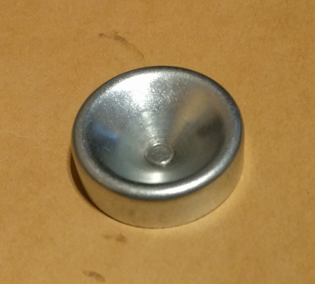

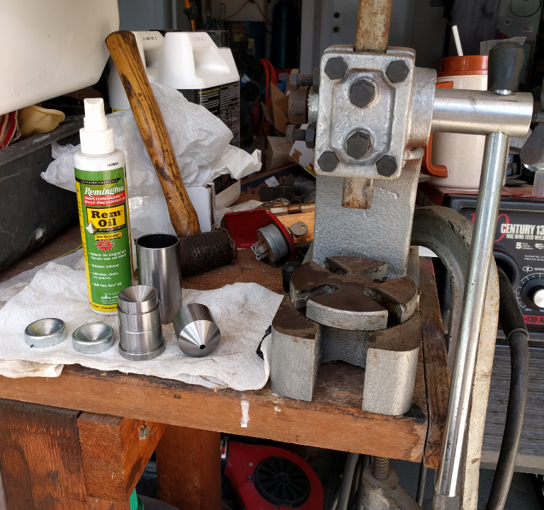

Here are the first two plugs after forming. I went ahead and formed all that I had, but that's about all I can do until I get my form 1 back.

Finally got my Form 1 in, it arrived between Christmas and New Year's. Starting to work on drilling things out and running into what may be a slight problem. How to accurately center the holes in the baffles. I formed them a few months ago, and I just assumed that the forming tool would put a centering mark on the freeze plugs. It did not, instead leaving a flat center approximately ¼" in diameter.
So, for the guys who have already done this, how did you center the hole? Did you get a centering tool and drill pilot holes before forming? Did you just eyeball it? Is there a trick I need to learn? I want to do this right.

AndyC wrote:First - congrats!
Second - my forming tool has a hole in it to act as a pilot guide for drilling the initial hole. In the pics you posted above, your tool appears to have one as well.
Ah, it's been so long since I formed the plugs that I'd forgotten about that!
(grumble, gummit, 7 months of waiting, mumble)
Okay, I'm back in business. Thanks, Andy!
