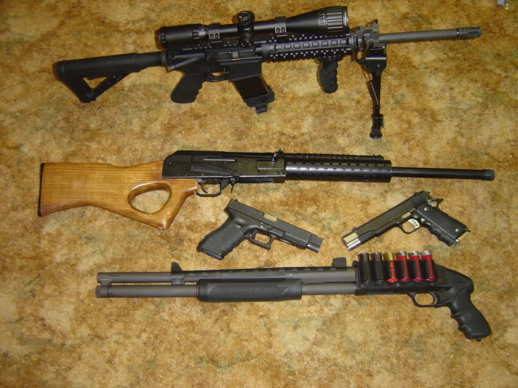

Re: Saiga Conversion
Thats my converted 308...
Millett DMS-1 ordered 9-18 cant wait to get it.. I shot pretty good groups at 100yards today with the stock irons.
