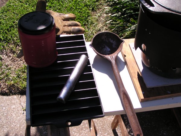

Finally got around to smelting the 150# of wheel weights I scored last summer with my home made furnace. I used a turkey fryer like Andy C & V-Rog used but I took mine all apart and made it smaller to fit a 2 qt. dutch oven and light enough I could put it up on saw horses so I didn't have to bend over it.
Pretty basic stuff; I used an old aluminum pot I got from Goodwill for the base, an old cast off burner grille from a gas stove I got for a dollar at a flea market, the wind screen, burner and hose/regulator from the turkey fryer. Its all mounted on a piece of hardy plank and 1/4" plywood. Melts a pot full of wheel weights in about 20 minutes.
Got two cornbread stick moulds from the flea market and they make nice 1"X1" X8" ingots.
Gerry

"img" tags. If you quote AndyC's original post, you can see the BBCode.Gyrogearhead wrote:P.S. How do you guys get bigger pictures in your postings?

Hi Andy,
The moulds are not as readily available as the corn-cob type but at flea markets and second class antique stores they can be found usually for $10 or there abouts. Same for the plumber's ladle; you just have to look "under the table and in the bottom of the box" as they arn't usually displayed with the nicer stuff. Had to pay $7.00 for the ladle because it is one of the "larger" sizes; it holds a little over two pounds of lead per dip so it pours one complete ingot with a little left over. The vendor I got it from at The Round Top Antiques Fair last spring had several of them but I had to walk away and then go back to his booth twice before I got his very best price.
"Used" cast iron is really cheap at flea markets compaired to having to buy it new at Academy or Bass Pro Shops and the old stuf is usually of a heavier-duty quality. Yeah, it's rusty and dirty but a few minutes with a wire brush and a little WD-40 and it looks a really good UPS brown (that's called Patina in the antique dealers parlance.) If you have the time to poke around flea markets and dicker with the dealers you can save a lot which means more $$$ to buy scrap lead & etc.
Gerry
