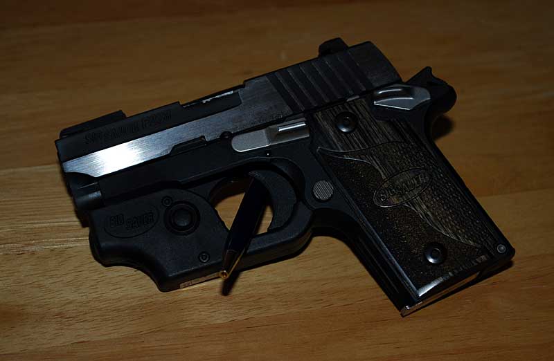

Here's mine with the Sig trigger guard laser and some pocket lint (it gets carried a bunch.) We've put about 800 rounds through ours. Note to self, order a couple of recoil springs (replace at 1,000 rounds I think it said.)
Cocked and locked.  One in the pipe and six in the magazine.

johncanfield wrote:Here's mine with the Sig trigger guard laser and some pocket lint (it gets carried a bunch.) We've put about 800 rounds through ours. Note to self, order a couple of recoil springs (replace at 1,000 rounds I think it said.)
They tell you that as do several manufacturers...but until you start having issues, I wouldn't bother prophylactically changing them. Just have one on hand.
I'll have to disagree with you, since we're talking about a carry pistol. You never know when it will start acting up, so I would faithfully follow the manufacturer's (hopefully conservative) recommendations.
For a range piece, sure. Throw an extra spring in your range bag & wait for the one in the pistol to start causing problems. You're not betting your life on that one.

Pawpaw wrote:
I agree I don't want anything that will/could create a problem for my life safety... however if you look throughout owners manuals, you'd be surprised how many guns tell you to do this. I was asking agun shop owner this very question on the 238, and he said his Glock was recommended at 2,500 rounds and he has over 10,000 through it. The 1,000 rounds was still based on when Sig was using the roundwire on these P238's, and haven't changed the info that they have a new designed spring. I am to be talking with aSig Armorer soon anyway and will ask him this and report back.
Edit: Just read the owners manual and it doesn't seem to say anything about replacing spring at any interval. Is there a quote or page on this? I searched a PDF copy using the word "spring" and looked at every instance. I would have thought there would have been something under the maintenance section of the manual.
