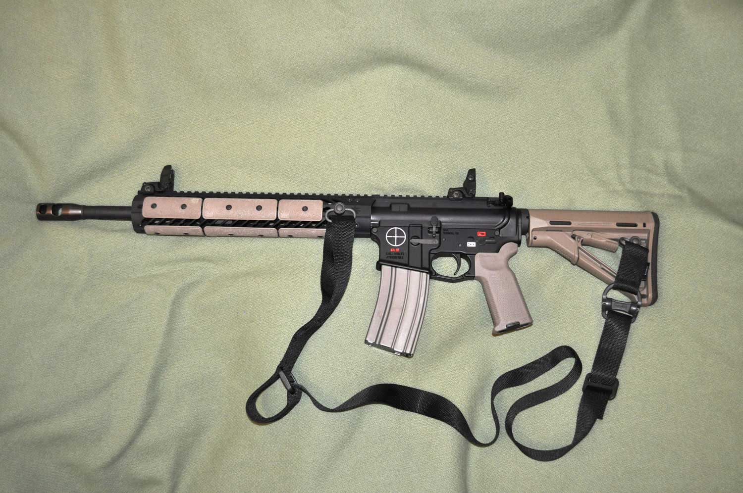

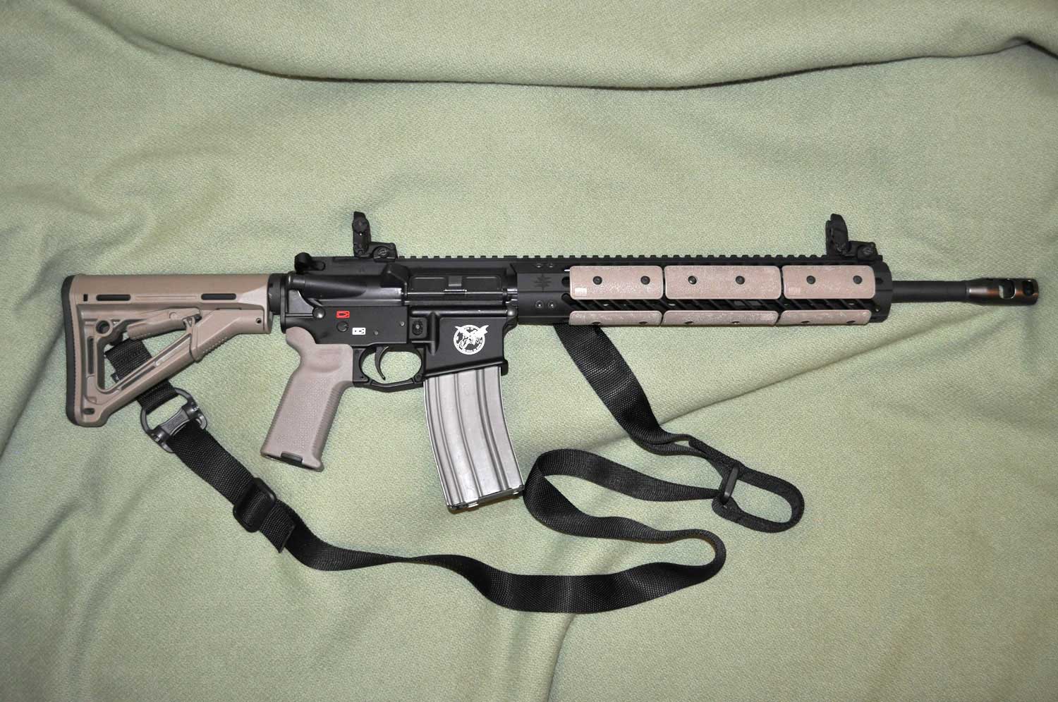

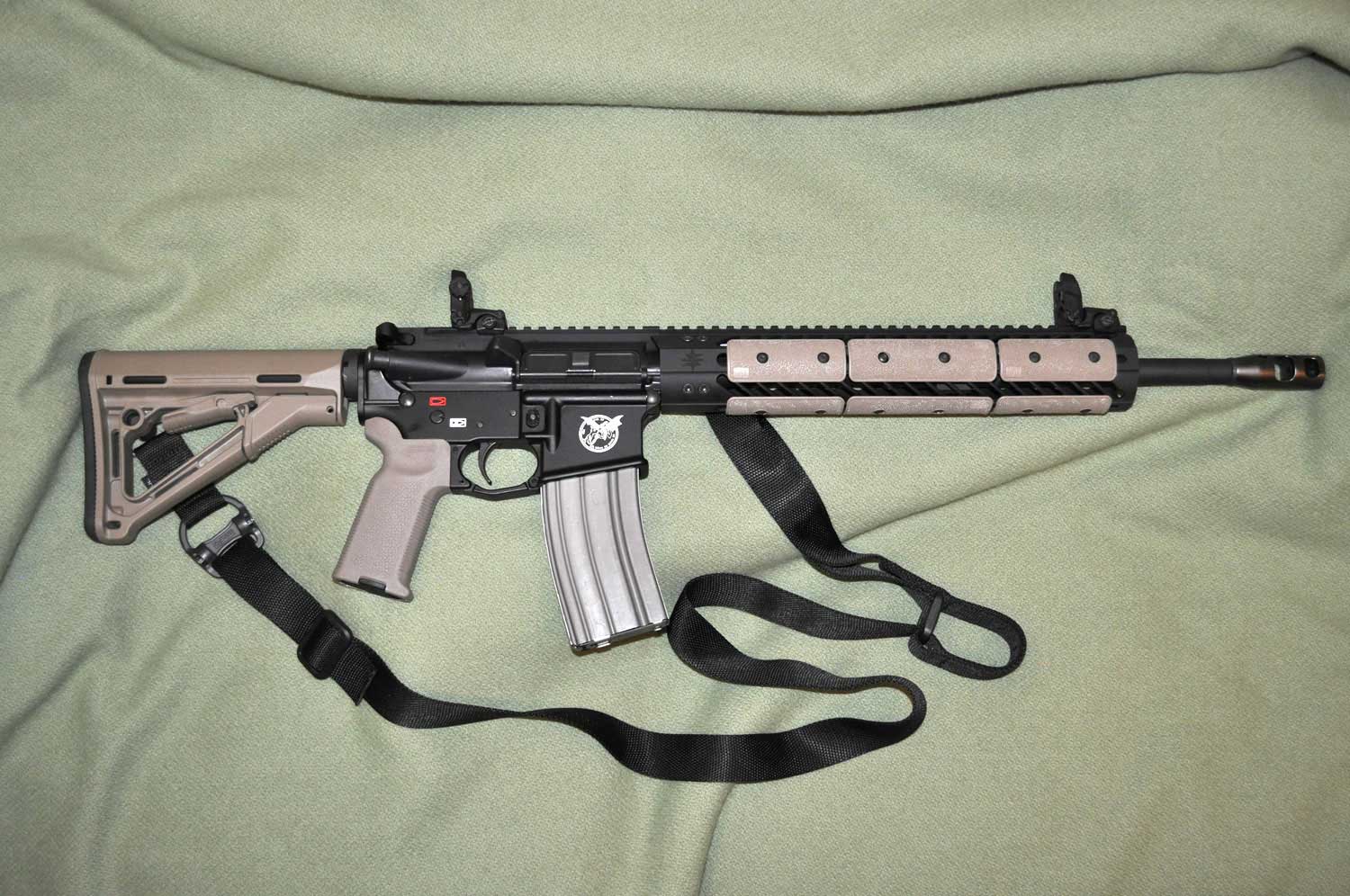

Now, my build really is final - except for the optic. There are other quality weapons in the safe, but this one is my favorite because I built it.
Magazine well with custom laser etching ensures I'll not sell this one.
Best value add-on? It's a coin flip between the stock or charging handle. I was surprised at the difference the BCM Gunfighter charging handle made (ease of use), but the Magpul buttstock was a solid improvement over the slop of the milspec M4 stock.
Long term, the gas piston kit will save me ton of cleaning time. But I've never minded that task, and enjoy it actually.

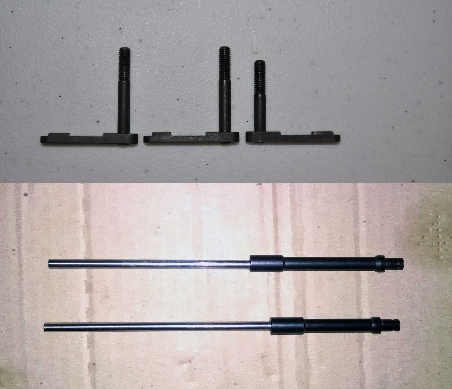

Had several minor challenges in the build, but only one weird showstopper. I had two magazine catches from separate bagged lower parts kits that were a 1/4" longer than carbine spec. Borrowed the correct one from an unused rifle. See attached image. Oddities have been tagged and put in the spare parts bin. If I knew what lower they went to...I'd probably have to build one of whatever it is. :mrgreen:
2 incorrect magazine catches top, Osprey operating rods bottom showing standard and nonstandard
Build list:
SAA SA-15 Lower
Del-Ton 16" Upper
Seekins MCSR V2 FF Rail
YHM-9383 Low Profile Gas Block
Osprey OPS-416 Gas Piston Kit + nonstandard operating rod for longer barrel nut travel
Magpul MOE-K2 Grip
Magpul CTR Buttstock
Magpul MBUS Gen 2 sights
Gladio Compensator AR15-AM
Midwest Industries KeyMod Panel Kit
Bravo Company Gunfighter Charging Handle Mod 4 (Medium)
Enhanced Trigger Guard, manufacturer uncertain, possibly Field Sport
Fortis QD End Plate

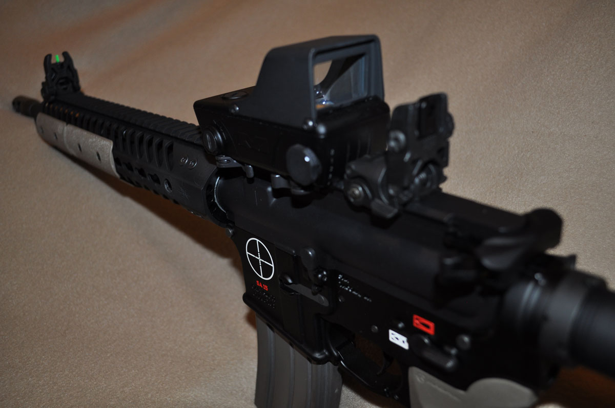

Optics. I'd narrowed my choices to the EOTech EXPS2 or Aimpoint PRO. With my less than 20/20 vision, I think I've reluctantly eliminated the EOTech. A new contender is the Mepro Tru-Dot RDS Red Dot by Meprolight. All are in the same price range give or take $50 from what I can find.

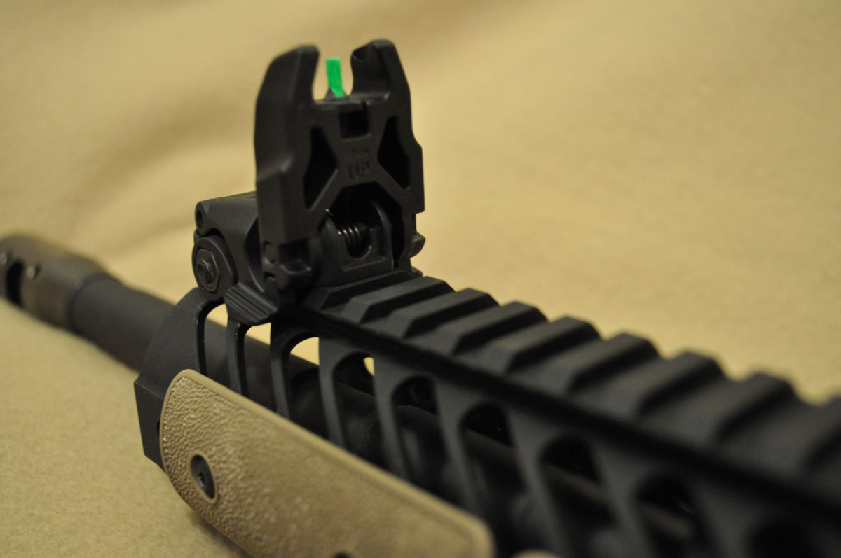

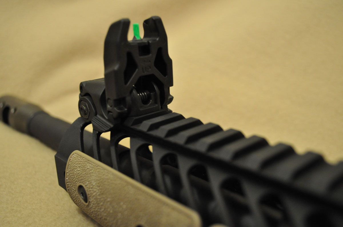

For kicks, I painted the front sight post of the Magpul MBUS on this rifle. Turned out pretty good, but I need to get it out in the bright sun to see if I can pick it up better.
And, I'm loving the Mepro Tru-Dot RDS optic.

Scott B. wrote:I had two magazine catches from separate bagged lower parts kits that were a 1/4" longer than carbine spec. Borrowed the correct one from an unused rifle.
wider for the new double stack magazines? :biggrinjester:
I am an AR noobie but thuroughly enjoying my bug infection as well. Some of the roll pins have been my nemesis. Something like you describe might have driven me bonkers trying to figure it out. Did you notice it before you tried to install them or did you have to fight it for a bit?

My wallet says I'm enjoying it too much too! Next on my list is either a AR pistol/future SBR or a 20" A4 (maybe an A2).
The odd magazine catches turned out to be for AR-10s, so I've got an excuse to build a 308 someday. The manufacturer sent me the correct catches for free and said to keep the others.
Edit: I'm confusing two of my threads.
The mag catch threw me for a couple of minutes before I decided I wasn't crazy and they really didn't fit. It just didn't compute but fortunately had others that I could compare with.
