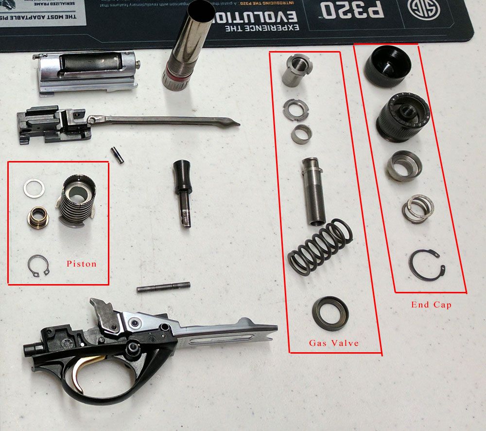

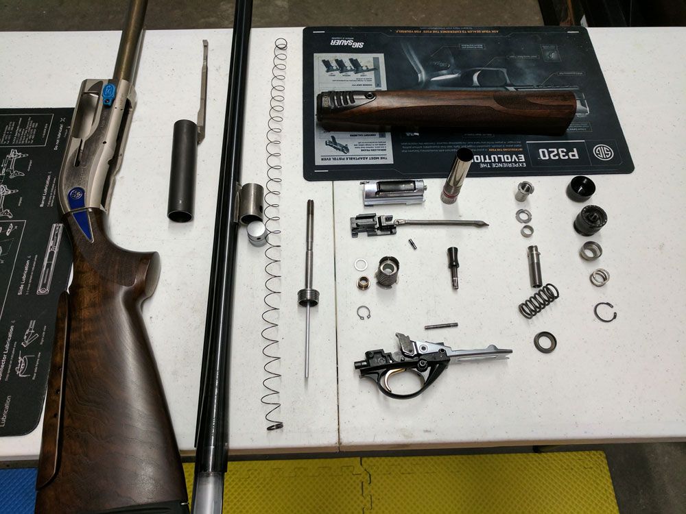

Here's a pic I shot a couple of weeks ago from the last major tear down of my AL 391. This is about 95% disassembled. Only things left to tear down are the firing pin/extractor, trigger, and buttstock.
On the left is that pesky piston we've been talking about.
