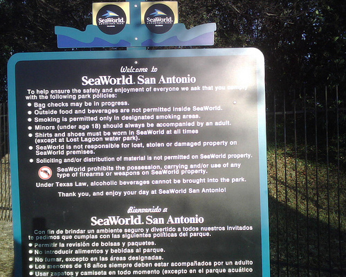

Many 30.06 signs have "gun buster" emblems on them.
Edit -- this isn't a 30.06 sign (obviously), but is on a parking lot entrance.

sjfcontrol wrote:Many 30.06 signs have "gun buster" emblems on them.
Under the new law, it looks like Sea World employees can have guns in their cars but guests can't, unless the guests are CHL or LEO.
Mine was in our car when we were there earlier this past summer. BTW, I thought they also has a valid 30.06 sign there but I planned on getting pretty wet and swimming, so I wouldn't have taken it in anyway.
