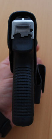

I've been reading this forum for a while and just joined. I got some Kydex from knifekits.com and made my own as well. I am in Austin and shipping was not too much. The .08 thickness is perfect for me. I have some .06 and it is too flexible for my taste. Anyway, tell me what you think. This is for a Kahr P40 and is very comfortable with the adjustable cant belt hook. Much more comfortable than I expected.
Belt hook is adjustable angle
Thickness compared to gun (gun is only .94 in)
Adjustable retention and detail of belt hook shape

Thank you, I am mighty proud of it I have to say. I used a toaster oven for the main part actually. Heat gun for the belt clip.
I tried the wife's hair dryer for some practice pieces and it works only marginally. Picked up a heat gun at harbor freight in Austin for $10, works much better.
