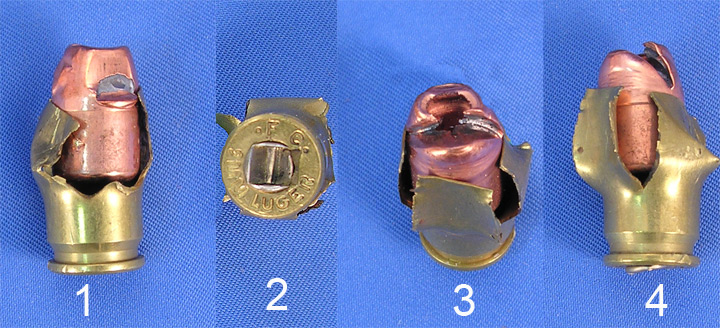

I was conducting our monthly Short Range Match when I heard a loud pop instead of a bang as a competitor was completing a stage. I looked up and saw the safety officer walking toward me with the shooter who was holding his left hand with blood pouring through his fingers. His pistol was lying on the ground where it had fallen from his hand.
The shooter's pistol had failed to go into battery and the shooter had aggressively hit the back of the slide with his left palm in an attempt to clear the stoppage. As he did this his left fingers went forward over the top of the slide just as the round detonated in the open ejection port. Fragments of brass severely cut his left index and middle fingers. After examining the shooter’s injured left-hand, a doctor at the scene determined that he was not seriously injured and only had some bloody, but not serious cuts.
When we retrieved and examined the pistol we realized that the remains of the detonated round were still in the ejection port. It was apparent that the round had nosedived into the feed ramp and that in doing so it literally positioned the primer exactly over the extractor. When the shooter slammed the slide forward with his left hand the extractor crushed the primer causing the 9mm round to detonate. If you look at photo #1 you can get an idea of the quantity of brass fragments that struck the shooter’s hand. In photo #2 you can see where the extractor crushed the primer (pistol was a Kahr 9mm). This particular gentleman is very forceful when he manipulates his pistol. Photo #3 show where the force of the detonation forced the bullet into the feed ramp. Photo #4 provides another view.

I believe he thought he had an out of battery condition and that the solution was to hit the back of the slide. He clearly had a different problem. Unfortunately, at the time I was more worried about stopping the bleeding and the condition of his hand so I did not ask him what he was thinking.
