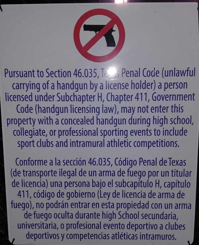

I went to a football game at a state university this past weekend, and looked carefully for a 30.06 sign before entering. I thought I saw one, so I disarmed and went to the game. After the game, while leaving the stadium, I took a closer look at the sign and was surprised to see it was NOT a 30.06 sign; it was a 46.035 sign (attached).
I have never seen nor heard of this type of sign before, and am not aware of any statute that defines it. Regardless of where it came from, it clearly does not meet the 30.06 requirements. Therefore, I believe I could have legally carried into the game.
Has anyone else seen this type of sign?

You are correct, without actual 30.06 verbiage at a public college football game, then 46.035 (b)(2) does not apply to a concealed carrier who is licensed.
(2) on the premises where a high school, collegiate, or professional sporting event or interscholastic event is taking place, unless the license holder is a participant in the event and a handgun is used in the event;
(l) Subsection (b)(2) does not apply on the premises where a collegiate sporting event is taking place if the actor was not given effective notice under Section 30.06.

Seems to me that sign has no statutory authority. 30.06/30.07 are the only signs (currently) that do.

I agree. I was curious if anyone else had ever seen one. It would seem odd that the university would just make up their own sign, but I guess anything is possible.Keith Bilbrey wrote:Seems to me that sign has no statutory authority. 30.06/30.07 are the only signs (currently) that do.

It could be a sign left over from before campus carry.

G.A. Heath wrote:It could be a sign left over from before campus carry.
That would make sense...but I was noticing that the sign said "handgun licensing law" which was terminology only used starting in 1/2016, so the sign would probably only have been used from January to August of this year. Now it should be a 30.06....although I wouldn't want to be the "test case".

The computer I was using earlier did not let me view the attachment, but I can see it now. Now that does make you wonder...ScottDLS wrote:G.A. Heath wrote:It could be a sign left over from before campus carry.

That is not even what 46.035 says, the words are there but you have to pluck them from different areas and leave out the intent of the law.
