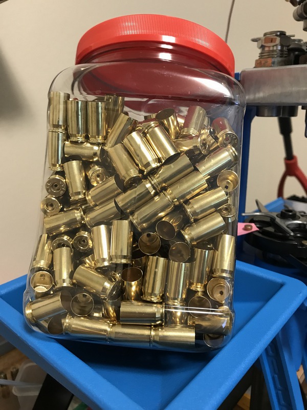

Here is an average batch:
My set up is just a harbor freight rock tumbler (2 drums) with coupon was $20 and a bag of SS pins $25 plus $5 for a bottle of lemmishine and $6 for a gallon of Armor All Wash & Wax. I still have 1/4 gallon AA W&W and more than 1/2 the lemmishine after cleaning roughly 15k pieces of 45acp brass. Talk about cheap.
my batch (each drum) is:
3/4 qt warm water
1lb SSpins
1.5 tsp AA W&W
tiny pinch lemmishine
100-125 45acp brass
Run it while I do other things and dump when convenient... anywhere between 1.5 hours and all day that fits my schedule. I just throw the brass on an old towel and run a little fan over it to dry for about 20 minutes (or until I get back to it)
I've learned that using a little AA W&W in my final rinse water eliminates the need to use case lube. I used to use case lube just to smooth out the press but this works better and eliminates 2 steps plus the sticky cases!

Those in the photo look like factory.
