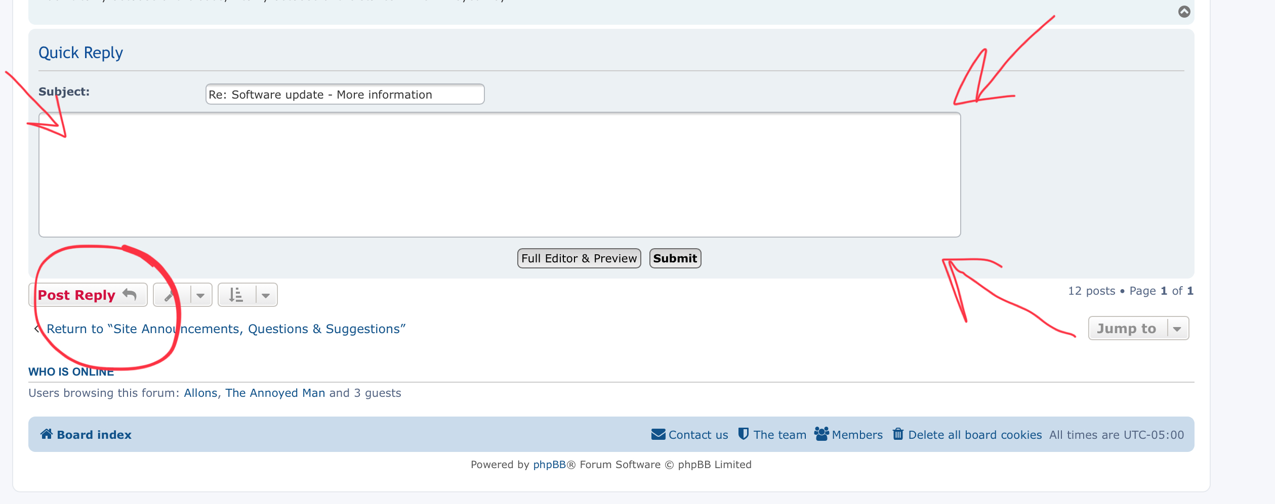

Re: Software update - More information
Use the “Quick Reply” field, or “Post Reply” button at the bottom of the page

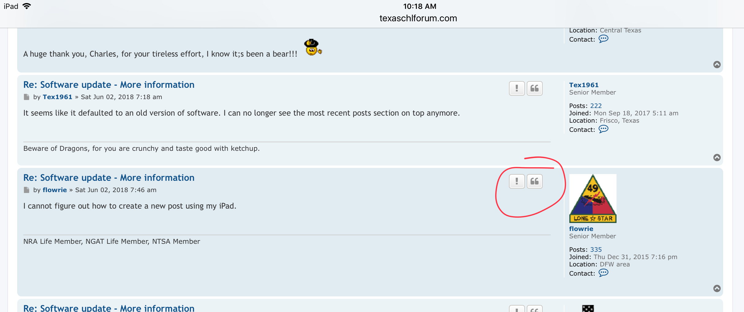

flowrie
Posts: 554
Location: DFW area
Post by flowrie »
Got it! Thanks!
Had to go to board index and select a topic or catagory, then the New Topic buttons appears.
A little different than the old way.
Thanks?
