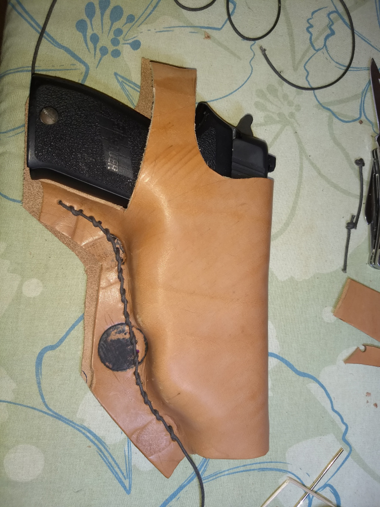

AndyC wrote: Thu Aug 22, 2019 1:52 pm Welt was glued in place and clamped overnight to dry. Came home at lunch to set out the holes (using a Dremel, thanks to flechero's great tip):
I wish I'd have known about drilling the holes back when I made some sandals on the 60's. I know getting through two layers of holster leather and welt is tough, but try sewing straps to double sole leather! You are doing some great work right off the bat, BTW!

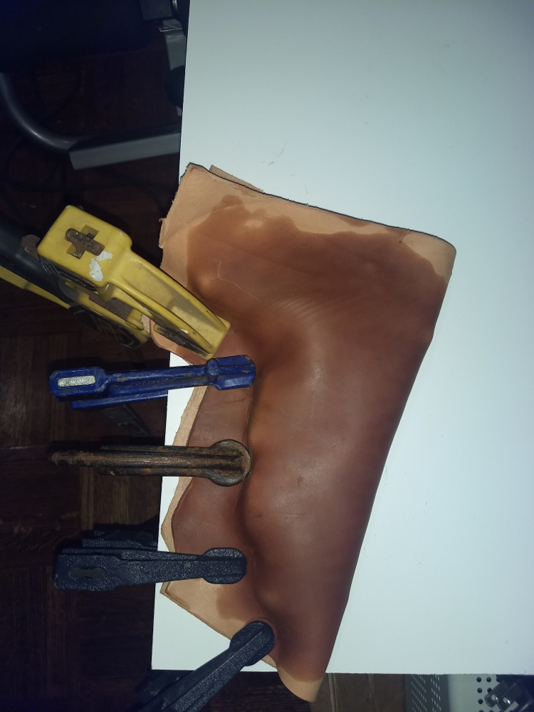

I'm doing my second attempt at leather. The first one is my EDC - works great for pocket carry, but it's not that pretty. No pics.
That middle clamp put a nasty stain on the leather, so now it's going to be black.
The first attempt at this post had the pics messed up. I'll try again.
The attachment IMG_20190826_012538937.jpg is no longer available

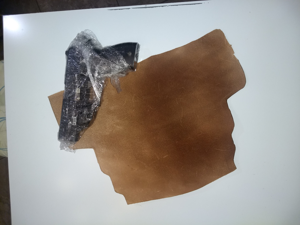

bbhack
Posts: 418
Location: Texas
Re: Holster part 2
Post by bbhack »
OK, same thing. This is the second pic.
