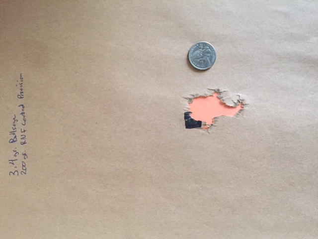

Bullseye is a versatile, fast powder suitable for a wide range of loads... the only downside is that it can be pretty dirty in light target loads. But that's not an issue if you clean and care for your gun on occasion! :lol: There is load data for 185-230gr bullets, readily available.
I've run it as low as 3.4gr in a 200gr. coated lead bullet, with great results.
