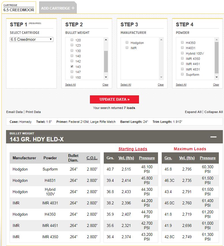

Helping a buddy get started in reloading and wanted to see if you guys had a Hornady book that shows the 143 gr. ELD-X, and might be willing to share with me? Maybe a pic of that particular page?

It's listed on Hodgdon's website:

I usually go there first but managed to miss it earlier.
