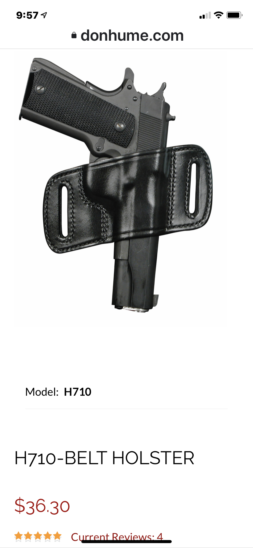

Re: OWB Retension preference
This with a good gun belt which is a must no matter what holster you use
I don't open carry but I do only carry owb. Don't care for iwb. My shirt is always untucked which means I'm always armed even at church. If my pants fit snug enough I'll use a Safariland paddle if not a belt and leather holster from DM Bullard. If I'm forced to tuck in I'll wear a tactical shirt underneath with the smallest auto I have.
