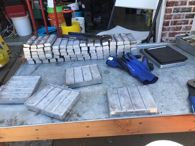

Making a bullet alloy
I was running low on my casting alloy, so I smelted some metals today - 50 lbs recovered range lead, 2.5 lbs 70/30 lead/tin solder, 6 lbs electroype gives me 58.5 lb of an alloy around 10 Bhn with 1.5% tin for good cavity fillout. Plenty good for my handguns.

Re: Making a bullet alloy
Are some of those ingot made in a cast iron corn cob bread baking pan?
Yeppers - it seems to be a thing among American bullet-casters, so when in Rome...puma guy wrote: Sat Mar 06, 2021 8:20 pm Are some of those ingot made in a cast iron corn cob bread baking pan?
