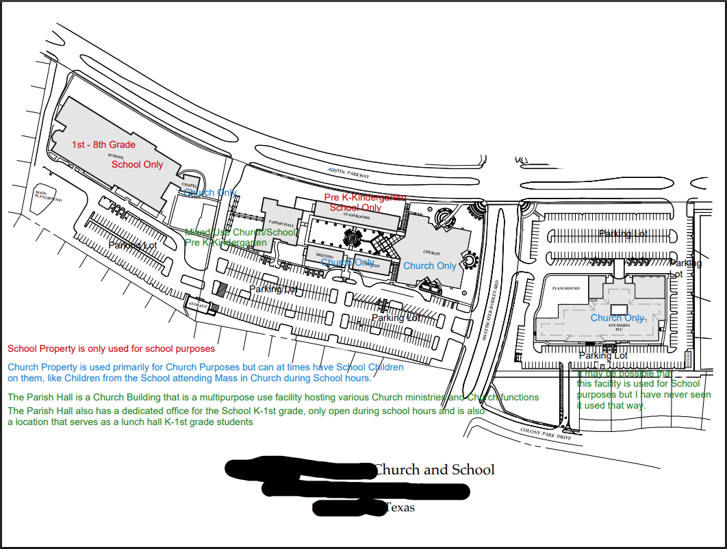

See the attached map. I do what I do regardless. But for the sake of argument, can you legally carry in the mixed use portions of this Church and School?
There is no signage anywhere.

Mixed use Church and School Facilities

Re: Mixed use Church and School Facilities
I agree the portion you're asking about would be OK area for carry if not otherwise prohibited. ie signage, etc.
Thanks for the reply!puma guy wrote: Fri Nov 07, 2025 5:01 pm I agree the portion you're asking about would be OK area for carry if not otherwise prohibited. ie signage, etc.
I forgot to add that the Church, Chapel ( physically connected to the school) and Center across the street are all open to the public where as the school portions are not
The mix use Parish Hall is generally only open for school during school hours and open to the public after school hours
