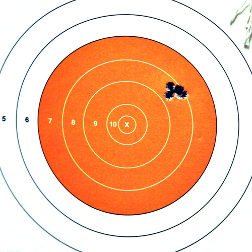

For .223 plinking loads, I've found that Vihtavuori N135 is a great powder, and I get *very* good accuracy and consistency with it. In my rifle using 55gr FMJ-BT bullets, the sweet spot seems to be 24.7 grains. My test batch gave me a 5-round 7/16" group at 50m:
This load pushes around 2950fps through my rifle. I've also had good luck with IMR 3031 at the top end of the load data from IMR - 24.8gr (compressed charge) using the same 55gr FMJ-BT bullets. These have cannelures, so all the loads I do with those bullets get an OAL of 2.230". I got 1/2" groups at 50m with this load, pushing along at around 3100fps.
For what it's worth, Varget didn't do well at all for me, and grouped terribly with every charge I tried. I think it's more suited to .308 than it is .223.
