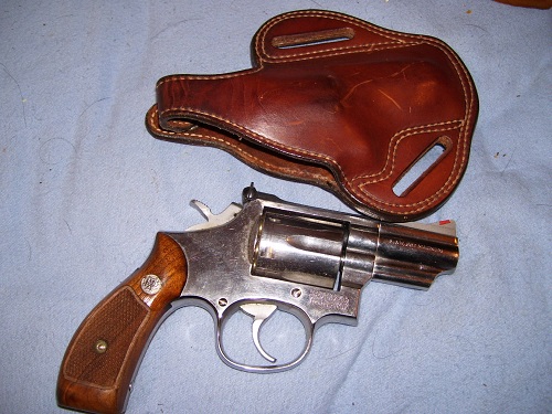

duallydondon
Posts: 44
Joined: Wed Jan 04, 2012 12:23 am
Re: S&W Model 66-2 Snub: First Shots
Post by duallydondon »
I have one that I find myself picking time after time to carry,,,mine goes in an older Bianchi pancake holster,,,Love it !!!!!!!
