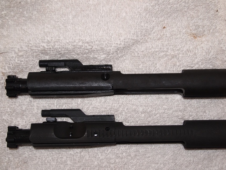

I just got the LH BCG in today. TAM is right on the money in his description. I will take some pics tomorrow in the daylight and post them with some pics of a standard BCG for comparison so ya'll can see the differences for you.
Another thing I just noticed. The upper is a complete stripped LH upper, so the dust cover came installed, upside down. Its built like this, the pin is made to go on top of the ejection port. After popping it a few times, I can see that the dust cover will definitely strike anything mounted on the rail directly above it. I'll post pics of this as well tomorrow.

Having issues getting the pics from my wifes camera to the computer. She's a nurse and works overnights so it would not be in my best interest to wake her up just to find a cable. I'll post picks of the pieces later this afternoon.
BTW, the pics did not turn out great, but you can see the differences.

All,
My apologies for being late with these.
See additional pics under next post.

All,
Here are the rest of the pics.
