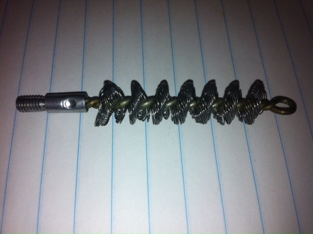

SQLGeek
Posts: 3269
Location: Richmond, TX
Re: HELP NEEDED - .357 Magnum doesn't fit my S&W .357!
Post by SQLGeek »
Charles, can you please elaborate on what a turbo brush is? I don't think I've seen one of those before and my Google searches aren't really finding me much either.

SQLGeek wrote:Charles, can you please elaborate on what a turbo brush is? I don't think I've seen one of those before and my Google searches aren't really finding me much either.
It's the size of a regular bore brush for each caliber, but it is made of stainless steel in a spiral pattern. They are terrible on a barrel, but they will clean a heavily fouled cylinder.
