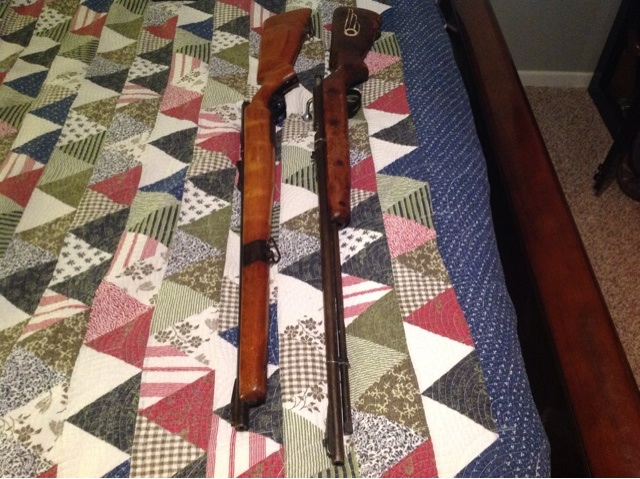

I have been given two 22's that were my great- grandmother's.
1. Mossberg M 51 1940's
2. JC Higgins 10313 22 Sears and Roebuck.
Obviously, there are legendary stories that come with them, and she was a great outdoorsman and huntress. I would like to get them serviced, and see if they can be taken to the range one day.

Thanks for the good info. The bolt is stuck open, and I can push it forward, but it will not close. I am not sure why it won't. Maybe something is catching?
