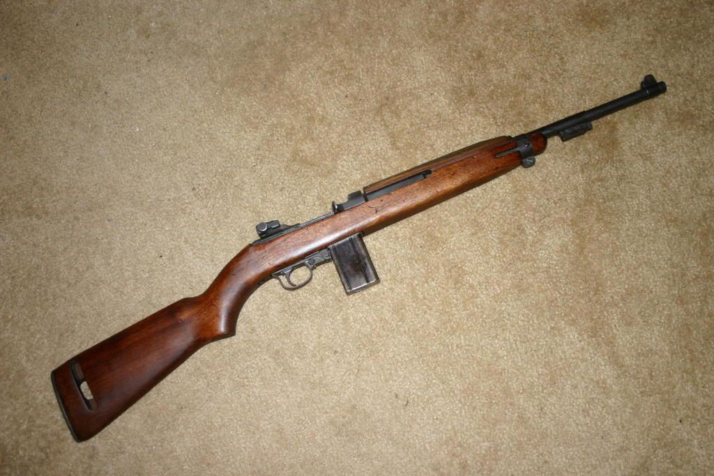

And, last but not least is my 1944 Winchester with Fairtrimmers oil...
:clapping: :cheers2: :thewave

Lookin good there Boomer! Nice work.
