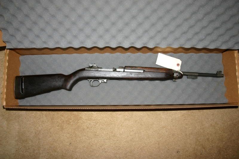

I have one Garand and two carbines from CMP. All were pretty clean but had spots of 50+ year old cosmo on the metal. Denatured alcohol took it right off. Simple Green or just regular old dish washing liquid will work well on stocks.
Fairtrimmer's Military oX is a great finish for old military stocks. :thumbs2: These are both boiled linseed oil.

This is one of the carbines as it arrived...
Then, after a good scrubbing with Simple Green...
Then I put on a coat or two of boiled linseed oil, which makes it darker like the military did. Now I'm using Fairtrimmers on a Winchester stock.
