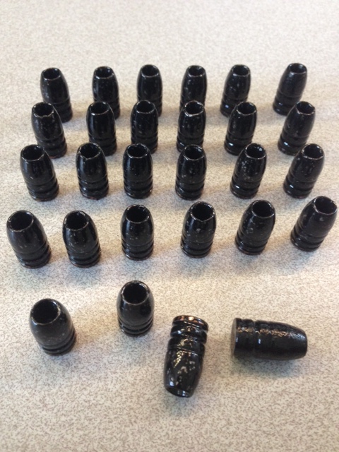

OK Just pulled the black out of the oven.
It did not coat as well as the red did for sure.
They may be covered enough to work, they just don't look as good.
I may end up keeping the black for other projects and use only red for my bullets.
I have one pound of each color, and so far I have only used about 1 TSP of powder for everything I have done so far. I may have a lifetime supply!

OK last pic for the day.
These are rifle boolits for my 300 AAC. I coated them, and tossed them on their side to bake them. I did not want to try and balance them standing up on the trip to the oven.
The only down side I experienced on this bake, was realizing I should have used a fresh piece of Non-stick foil. The only ridges and imperfections were from the boolits sicking to the powder that had been cured to the foil from previous batches. Other than that, there was not any globing or any imperfections I could see.
I am done with my initial testing for now. I need to cast some fresh slugs and experiment with other variables. (amount of powder, amount of Airsoft BB's, Temp, humidity, etc)
It has been fun. Now time to stuff them in some brass and check function and accuracy!

ddstuder wrote: Chas, I bought some of the gloss black from Smoke also. I am getting ready to test it out next. First impressions, I notice that it does not coat as evenly as the red powder.
Your bullets look great, especially for someone who just started. I'm beginning to think there's something problematic about black for dry tumbling. Most everyone who tries black reports coverage less than optimal compared to almost every other color. In fact, I've only seen one photo of black bullets that were dry coated (swirled) and look perfect. See post #24: http://castboolits.gunloads.com/showthr ... t-em/page2" onclick="window.open(this.href);return false; Here's a link directly to the photos http://s26.photobucket.com/user/jameslo ... 5.jpg.html" onclick="window.open(this.href);return false;
