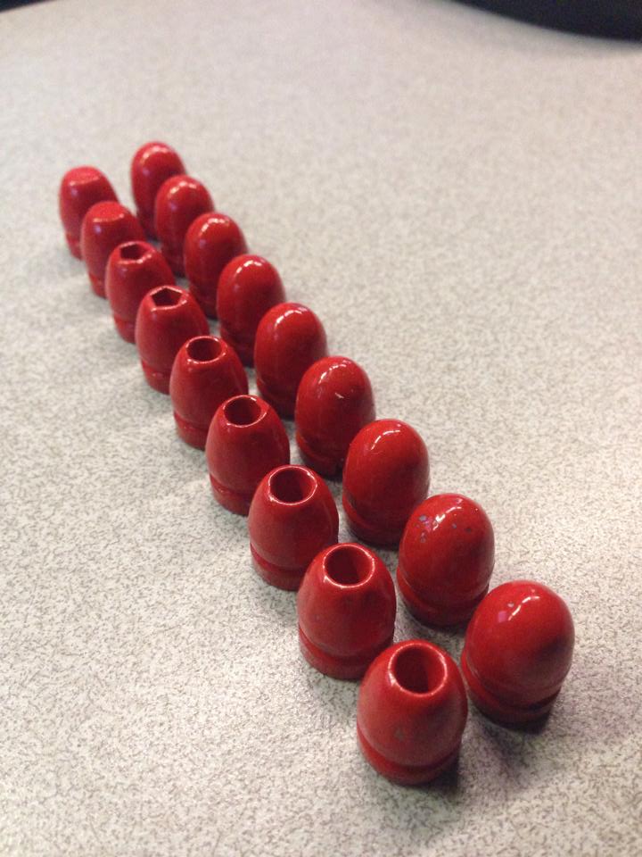

This is my first attempt at powder coating boolits. :hurry:
I did not have any fresh cast, and it is too hot to stand over the 700 degree pour pot, so I just heated up some previously cast boolits to melt the grease out of the lube rings.
After melting the wax with a heat gun, I soaked them in gasoline to remove the grease. I have not doubts that fresh cast boolits will turn out better.
I am using the Dry Tumble method of PC using airsoft BB's as a medium to create static and distribute the powder.
I tumbled them for about 3 minutes and then baked them in my $10 goodwill toaster oven for 15 minutes.
Seeing the results and how easy it was, I believe the quality will only improve from here on out. I purposely rushed this test batch to see what kind of results I would end up with. So far I'd have to say, I have a new way to lube my boolits. :drool:

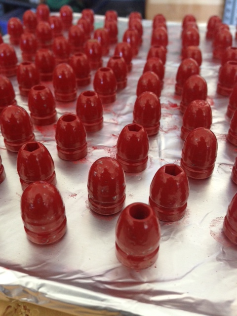

Just ran a batch of 90 pills for my 45.
This batch was applied with less powder in the bowl and with fairly high humidity.
This batch looks better than my test batch last night. This is only the second tray I have ever done! I think it will only get better with more practice.

Everyone seems to complain about having to put the boolits on the tray. I do not find it cumbersome at all.
I am coating them in batches of 50, and it does not take long. I can easily have the next tray tumbled and stood up, and enjoy a beer before the baking is done on the first batch. I tried a batch of 100, but my baking tray is a little too flimsy for that much weight.
If I was using my lubrisizer, I would still have to grab each bullet one at a time, orient it the correct way, pull the handle, and then remove it from the sizer.
So for me setting them up on a tray is a non-issue.
