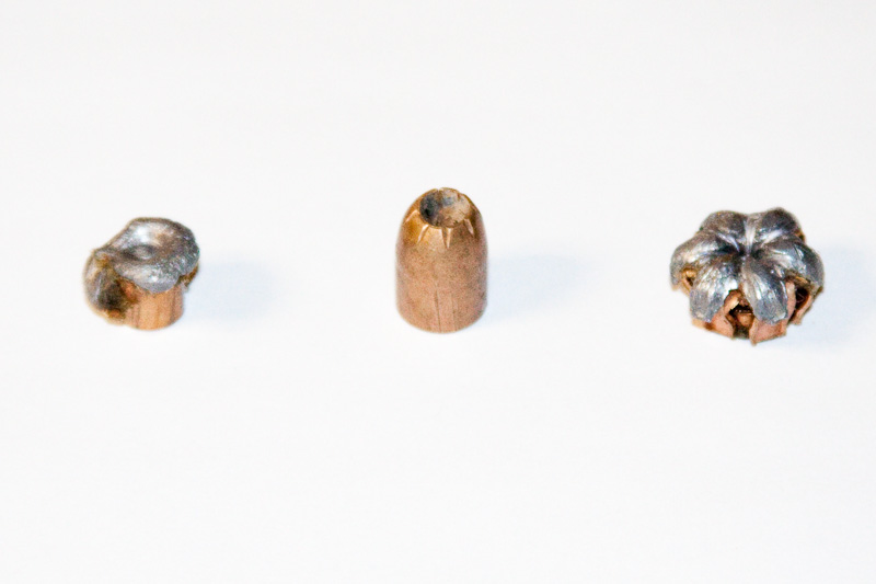

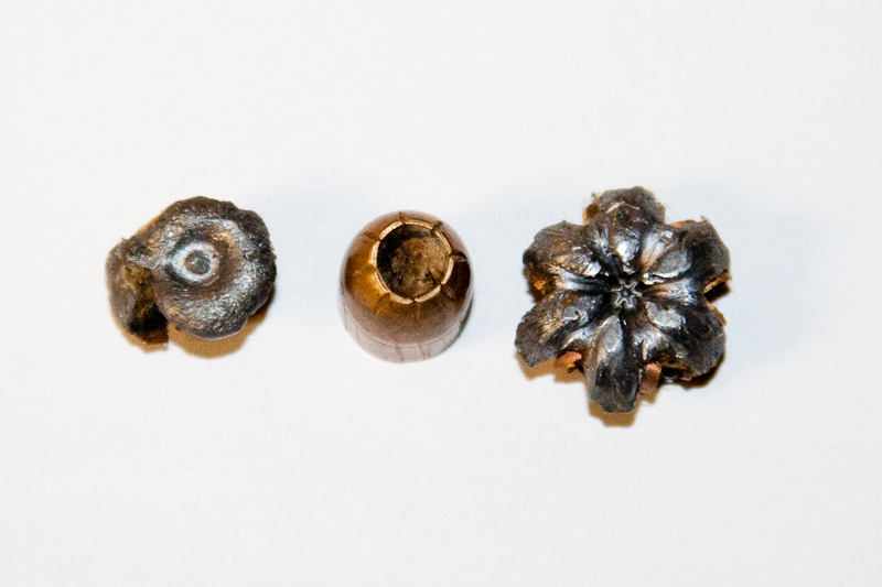

I've been meaning to do this for a while but never got around to it. This hunting season we killed a couple of hogs while out deer hunting. After taking the hams off them, I decided to do a little experiment with some ammo I have. For the experiment, the hog was on the ground, laying on his side. All rounds were fired out of a 4" 1911 gun, at approximately 3 feet from animal. Each round was fired in the ribcage, just behind the front leg.
In order of appearance, from left to right
Federal HydraShock 9mm 124grain JHP
Winchester Personal Protection 45ACP 230grain JHP (sold at WalMart)
Federal HST 45ACP +P 230grain JHP
As you can see, both Federal rounds expanded per their design. The 9mm Hydrashok expanded to be slightly larger than the Winchester .45acp. The biggest dissappointment was the Winchester Personal Protection .45. Althought being a JHP, it acted like a FMJ. Both Federal rounds did not penetrate completely. They penetrated both sides of the ribcase, and were both found embedded under the skin under the opposite side of the animal. The Winchester shell penetrated completely through the animal, and went about 6 inches into the ground. The exit hole was simply the size of the bullet.
The cavity created by the Federal .45act HST and 9mm HydraShok was consideral in size, while the Winchester Personal protection .45 didn't appear to do much internal damage.
Based on this experience, I would carry a 9mm with quality self defense round before I carried a .45 with fmj, or cheap JHP rounds. It's one thing to read what the manufacturers say on their website, and another thing to see the performance in real life. In the case of self defense ammo, I am a firm believer that you get what you pay for.
