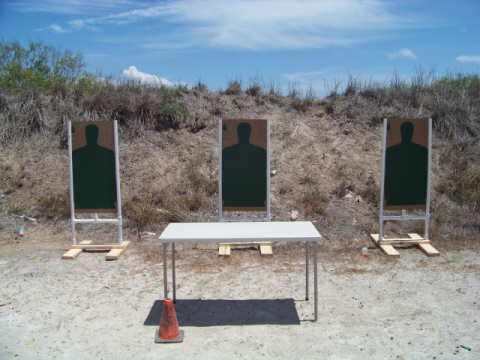

Seabear
- Posts: 781
- Joined: Sun Mar 07, 2010 1:36 pm
- Location: Corpus Christi , TX
Re: Cardboard Targets
I'm high dollar. I like the cardboard targets because if it rains a little while shooting they don't fall down like paper. I have h frames made from 1 1/4" PVC with a groove cut on my table saw to slide the cardboard B-27 into. I also have the replacement 8 rings that only cost about 12 cents. If someone wants their target I just put another one up. I recycle the used ones for my own shooting with the replacement sheets.
My pvc frames mount to a 2x6 base H shaped as well, and heavy enough not to blow over. On top of the board I have two 1 1/4 pvc caps bolted down with bolts and washers that fit the inside of the cap. They have been great for a long time. occasionaly someone will shoot a side pipe. Those aren't glued in so they are replaced easily, in fact I just made 8 more today. I also learned to use thin wall stuff because it doesn't shatter. I'll have to see if I have a pic.
I found one, like they say, a picture is worth a thousand words. Since taking these pics which was my first design, I have eliminated the center t at the bottom, the cardboard does not need it. I have also shortened the side pipes to 36" so I don't have to lift the targets so high . (had shoulder surgery)
