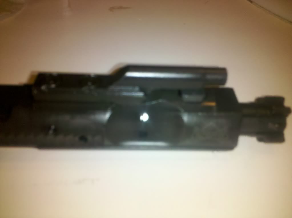

Just ordered myself a couple of these
one of these
and a grab bag of little pieces that look like small gun parts:
Wonder if I can make them into something? :mrgreen:
I want a 20" upper, I'm pretty set on BCM. Then BCG handguards and a carry handle!

Great kind of project to start. They are tons of fun to build and even more fun to shoot. Aim is a great company to deal with. I have done thousands in business with them and would continue to do so. Have fun and take your time building the lower.
Rex B
Posts: 3616
Joined: Thu Jul 06, 2006 3:30 pm
Re: New project
Post by Rex B »
Those $60 lowers are a real bargain.
One tip for you: when it's time to inset the front detent pin and spring, do that part inside a big plastic bag - big enough to get both hands and the receiver inside.
OK, two tips: Get a long 1/4" bolt, cut off the threaded part, and cross-drill it so the detent pin will pass through.
The above will save you a lot of time on your knees examining the carpet in the dark recesses of your work area, then waiting for the replacement pin to come in the mail. :banghead:

Texanron: I decided to build a rifle length system because: I already have a carbine (might be HAD soon im considering selling it to fund this.) and I think it would give me a little more accuracy, stability (fixed stock) and muzzle velocity. I'm going to keep iron sights so I can work on my marksmanship with them. EDIT: also I have this crazy Idea for a pig hunting upper, and I want to be able to just mate it to my rifle buffer'd lower. Maybe a 6.8? maybe just a SS bull bbl with a place to mount my flashlight?
Rex: I've been there and done that! When something springs out and it hits the ceiling you know it's going to be a long day! I learned to start using a plastic bag after waiting 3 weeks for a replacement rear sight for a S&W wheelgun. After waiting that long i was real careful :cool:
I ordered up a few more parts for this, I got the upper receiver from Palmetto State, as well as the lower (found them for the same price over there). Barrel will be a CMMG gov't profile. I also built myself I nice work table with a vise. Can't wait to get started :txflag:

I picked up my lower today and it only took me about 2 hours to get the lower assembled and the stock attached. Not too bad, had a few scratches when my pliers slipped :banghead:. My guns all end up like that in the end so I've stopped worrying about cosmetics.
I put the forward assist and ejection port door on the stripped upper, and assembled the delta ring/barrel nut assembly (it was a pain I wish I had snap ring pliers). All I need now is a carry handle and a barrel assembly! :woohoo
I'll snap a few photos later if I can.
