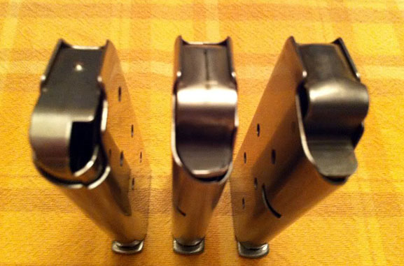

You didn't say when yours was made - there are three generations of magazines, be sure yours look the left-most example in the below picture. Also, be sure your recoil spring is made from flat stock - that's the latest version.

Left mag is the latest generation

My p238 doesn't have a flat spring. I haven't had any problems evn using a wide variety of ammo including some +p. I should call sig and have them ship me one though..

So.. do you have the gen 3 magazine?

Gen 3 mags, both of them.
