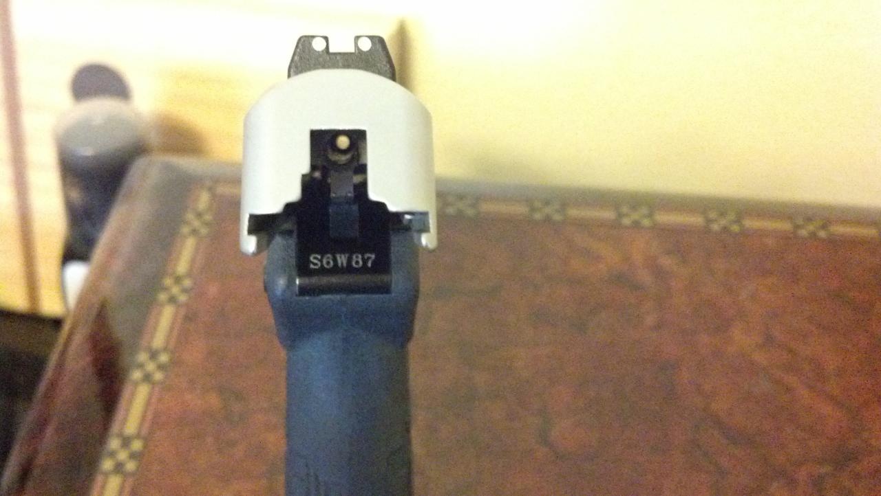

Turns out I didn't describe it right earlier...the extractor did not shear off - the screw holding it in backed out, which caused casings to not eject and also let the firing pin fall out the back of the pistol. I thought the screw was attached to the extractor.
What a piece...
Pics

By the way, your buddy was supposed to use locktite on that extractor screw when he reassembled the pistol. So, that particular failure is more likely an operator induced error in maintenance.

:iagree: Have carried and shot the PF 9 for years. The thing about lock tite on the extractor screw was, I thought, common knowledge. I know they come from the factory with it on the screw.

FWIW I have seen a wide variety of firearms run through qualifications and none of them have the frequency and degree of failures that the Kel-Tecs do. I don't consider myself an expert by any stretch, but in my personal and professional life, I have seen MANY handguns run through various courses of fire. I would suggest that ANY handgun attempting to present itself as a serious defensive weapon that requires the regular application of a thread locker to prevent a catastrophic failure is not to be taken seriously. I'm not talking about a sight post flying off, this is a game ending failure. I'm not trying to step on toes and say your brand sucks...but I can't for the life of me wish for any of you to reach for that thing and squeeze off a life-saving round, only to have the gun fall to pieces in your hand, eliminating the possibility of follow up shots.
