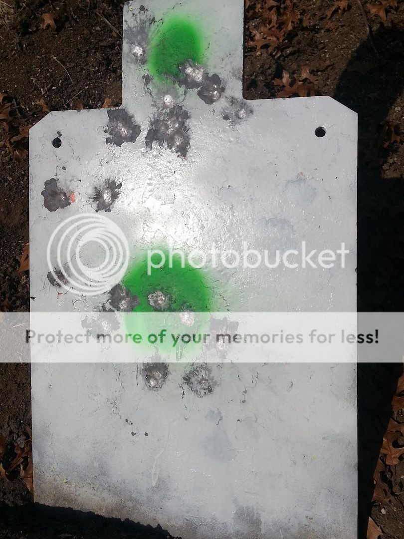

Note, for those who load for precision rifle shooting, the joyment and the feel of achievement and being proud is priceless.
Especially, when you hit headshots at 500 yrds. :hurry: :hurry: :hurry: :thumbs2: :thumbs2:
