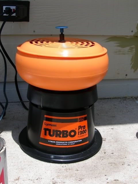

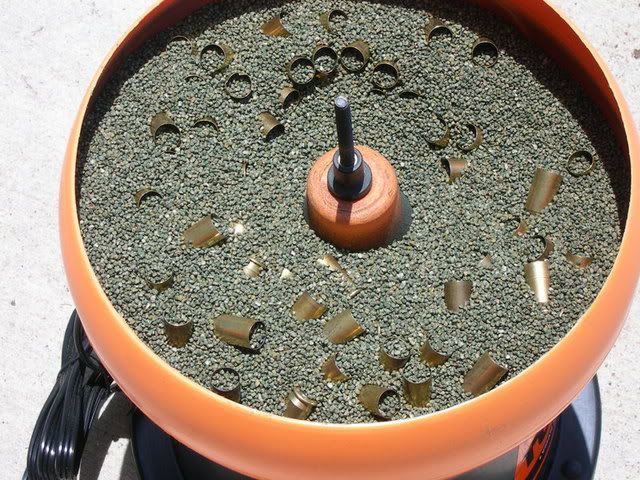

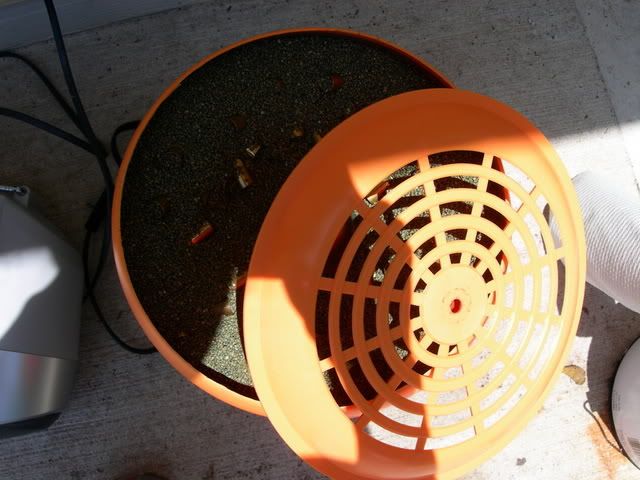

I bought a Lyman tumbler to clean brass. (pictures below.) I'm using Lyman's corncob green as a cleaning agent. How often do I need to change out the cleaning agent?
