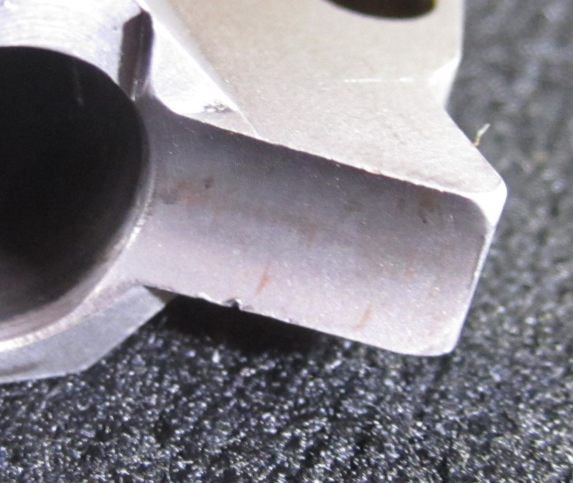

I started looking for suspects. The feedramp has two imperfections. The obvious one, and the one showing up as a discoloration 2 mm down the feed ramp from the chamber. I can feel the discoloration with my fingernail. Attempting to attach a picture for any comments you guys have. Acronym 12/2/2016 9:10 AM

Now, looking at the picture you posted, looks like you could polish the feed ramp, removing the burr and that may take care of your issue.
