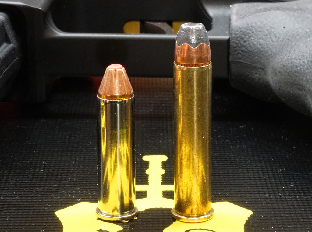

357 magnum vs 357 maximum (or as some call it, the supermag) There are actually a couple on GB if you look.
