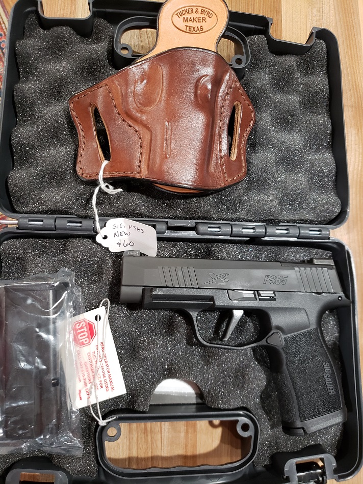

Thought I would start a thread about my new P365XL - I referred to it in my other thread about having problems with my P239. It's really a dandy size, holds 12 rounds plus 1 and seems to be a very pleasant shooter. I had no idea it was just released maybe two or three weeks ago and seems to be in short supply. I gave 600 bucks cash at the Kerrville gun show yesterday which is a bit over retail but that's okay considering it's so new on the market.
I've watched a couple of videos on the 365XL, one guy put 1500 rounds (or something like that) through it with zero problems and even poured water on the slide to cool it down when it got too hot to comfortably handle. I think the 365 had some teething problems which doesn't surprise me and I think the XL incorporates some design tweaks from the problems with the 365. I had to send our Sig P238 back to Sig once or twice when the 238 was a fairly new model but they got it going fine (great little pocket gun.) I don't have an opinion about the 365XL trigger as yet since I've only shot about 25 rounds through it.
I spent quite a bit of time handling the P365 a lady was selling so she could buy the XL version, I liked it quite a bit but after handling the XL, the XL seemed to have the perfect dimensions and weight for me. I was curious about the P938 (basically the P238 in 9mm for those not familiar with Sig) but I thought it was too small for a 9mm round and wouldn't be fun to shoot unlike the P238.

Started having fail to feed problems after about 150 rounds of various factory ammo. To my amazement, Remington UMC target 115 grain ammo would not load - period. No way Jose. PMC 115 grain full metal jacket worked great, I also ran Geco 124 grain FMC with no problems. Winchester Law Enforcement 147 grain hollow points were feeding fine then I had one get stuck to where I couldn't extract it or drop the magazine. I finally locked the slide back and pushed the casing to the rear, then I could clear the round. I think one of the magazines has a weak spring - the tension when loading (with a speed loader) was noticeably less than the other.
As far as shooting, I like the trigger overall (not a crisp break but good enough) but I'm not sold on a straight vs. curved trigger finger pull. My finger kept sliding to the bottom and rubbing on the trigger guard. Maybe Sig can change it for the traditional curved pull. I was hitting the target consistently to the left but I thought that was me and not the gun, I did manage to get that solved by concentrating on my stance and trigger pull.
I'll call Sig tomorrow and get a return tag. I'm not particularly upset, it's just one of those things. One advantage of sending it back is the gun will get a good examination and tweaking over and above factory assembly and testing.

Talked with Sig yesterday, "shoot 500 rounds through it to polish the feed ramp." So this morning I polished up the feed ramp with my Proxxon rotary tool and a very, very fine stone - saved me a ton of money, but I ran another 100 rounds through it this morning and it's doing great. Even the Remington UMC target ammo that would not even begin to feed, feeds fine now with no issues. After I get a couple of hundred more rounds through it I'll run some carry hollow points through it.
I'm beginning to figure out the sights and my grip, etc and can put all rounds within 12" from about 20 feet (with an occasional flyer) - pretty good for this old guy with wonky hands. I'll tighten that impact zone up a bunch the more I shoot the gun.
Sig does list a curved trigger for the 365XL - the Sig guy said nobody ever asked him about replacing the flat trigger, I'm the first. :thumbs2:
So the bottom line is - I'm really happy with the Sig now. Very happy.
