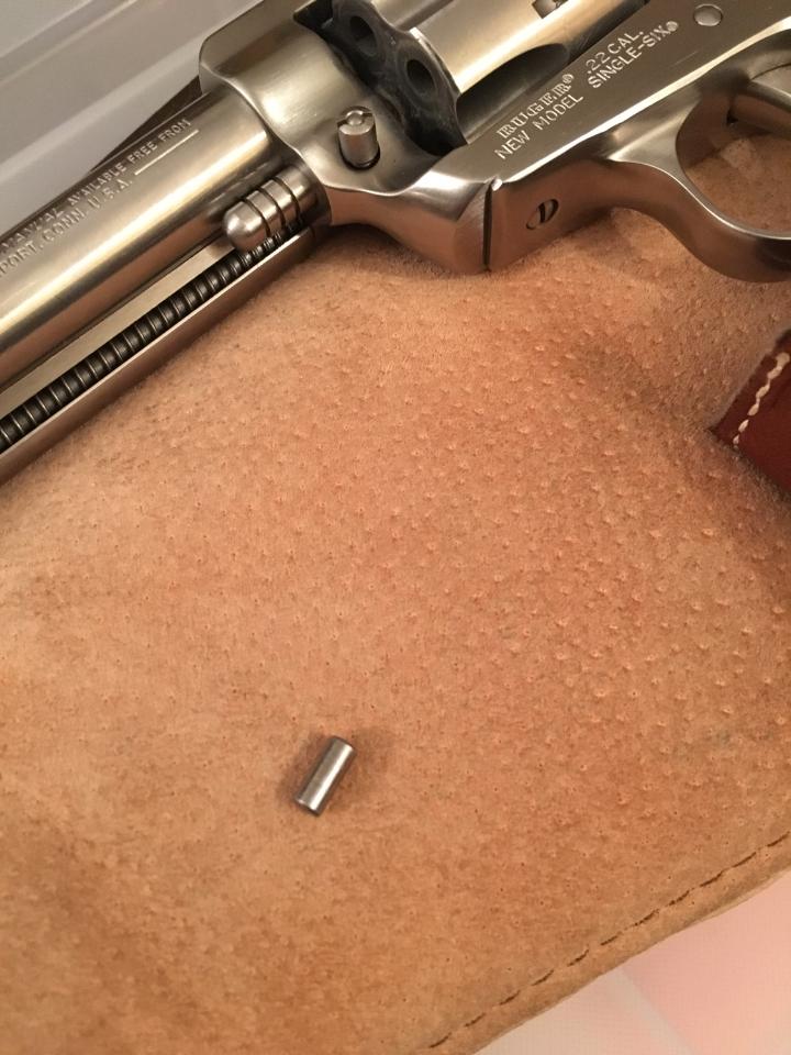

This is a ruger new model single six with both 22lr and 22 wmr cylinders.
Can anybody Identify the small pin and what part of the gun it may go to.
Thank you.

https://www.gunpartscorp.com/gun-manufa ... e-6?page=4
8 or 31
Cylinder latch spring plunger
Pawl spring plunger

BHill wrote: Thu Sep 12, 2019 10:08 pm https://www.gunpartscorp.com/gun-manufa ... e-6?page=4
8 or 31
Pawl spring plunger
31 should be stepped to hold the spring. Don't know 8 could be possible.

It looks like part number 24 to me.

03Lightningrocks wrote: Thu Sep 12, 2019 10:22 pm It looks like part number 24 to me. It holds the grip from slipping away from each other after they are tightened onto frame.
This is my thought as well.
I am not positive as to it's purpose but that is it for sure.
A grip pin stops them from rotating and maintains the correct location.
I only hope it's that simple
8 or 31
Pawl spring plunger
On gunparts site , page 3 , part 24 hammer plunger pin is looking like the part. It gives a good picture.
