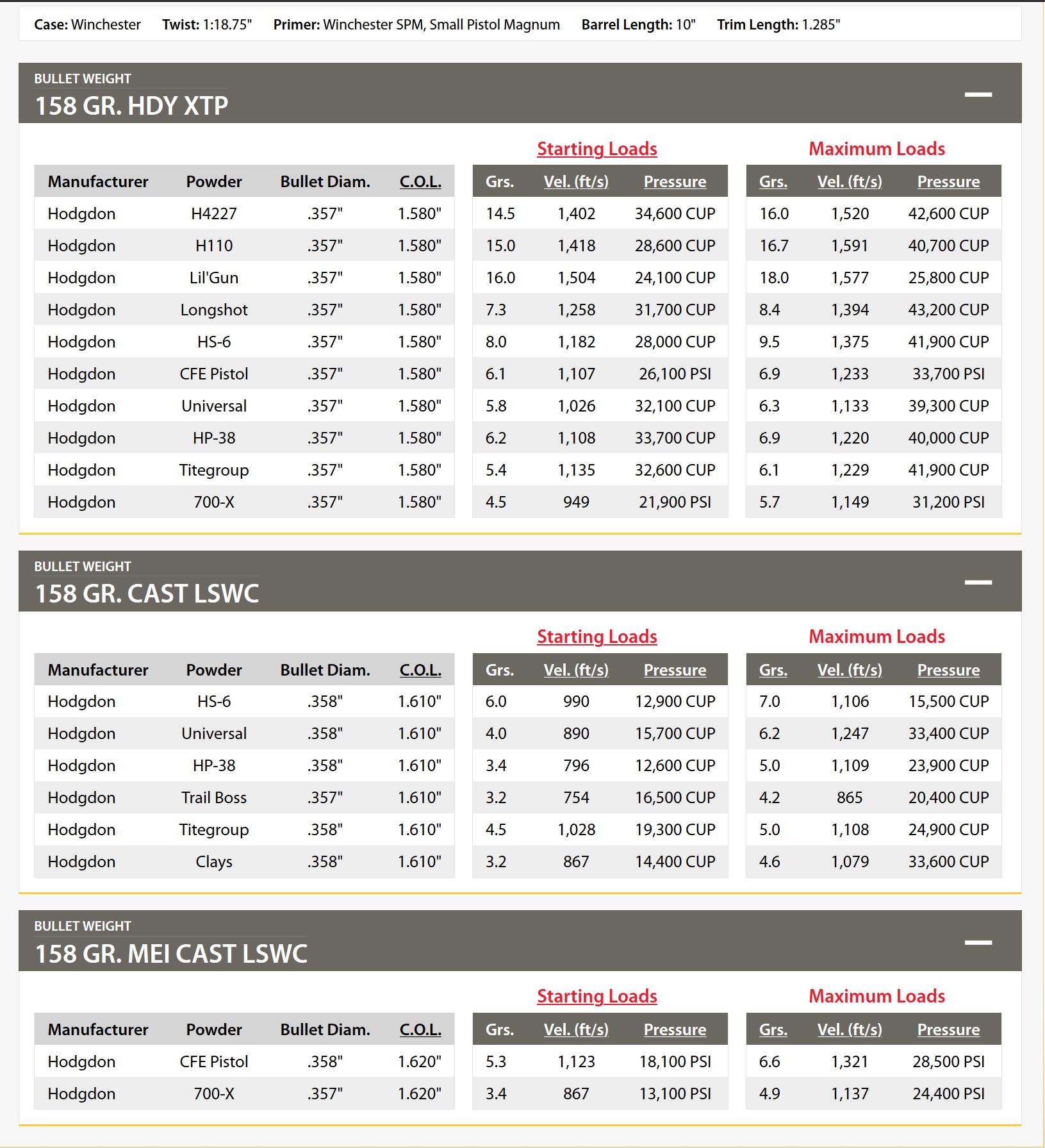

See attached.

All of the reference material I have looked at says to use magnum primers for .357 magnum loads. It does not differentiate by powder. I am not experienced enough to deviate from proscribed loads which is why I'm asking.mr surveyor wrote: Wed Jun 17, 2020 9:42 am I don't understand the concern over using standard small pistol primers with A-2400 in the .357 mag (or the .44 mag).
It's all in the books.
My understanding was that 2400 needed magnum primers, having researched more I see in Alliant's data that is not the case.

On the primer issue, flake powders do not require a magnum primer. As far as 2400, it kinda gets down to the handloaders preference. Also, when magnum primers are used for all powders in the data, that data will be somewhat reduced because of the magnum primers. AA No 7 and 9 are a couple of other examples
It might not be easy these days to find .357 Magnum data where primers were selected to match the specific powder. The data I have where standard primers were used comes from the Accurate 2000 - 2002 load guides. But be advised, since that time, Accurate has had their spherical powders made in the US by St. Marks. The older powders came from EXplosia/Lovex in the Czech Republic, and now available under the Shooter's World label.

The thing here being sensitivity or insensitivity to powder positioning. One reason that Titegroup is as popular as it is. It doesn't matter how the powder lays in the case when cartridges are being fired. Same with AA No 2. A lot of handloaders are not aware that TiteGroup is also one of the hottest burning powders you can use, and exacerbated by using it in high pressure cartridges. For the lower pressure types like .38 Sp. and .45 ACP it does fine.
In the "medium" burn rate group in regard to what's been mentioned with BE86, AA No 5, Power Pistol, True Blue, Silhouette, CFE Pistol, 3N37 and N350, or HS6, where case-fill will be around half or less, True Blue is the least sensitive to powder positioning with 3N37 being a close 2nd. Power Pistol will produce an impressive Fire-Ball out of the muzzle, enough so that I'd use BE86 over it. But as far as pressure stability, True Blue is in a class by itself. It's also capable of reproducing factory load velocity when needed. That you'll see in the Lyman 49th, and you will also see that among all of the powders used by Lyman in their .357 Magnum data, it was actually True Blue that they loaded to the highest pressures even while there are slower burners in the data.
As far as the powders best suited for full power magnum loads, the choices for me really begin with AA No 9 and 2400. That doesn't mean that AA No 7 get's left out in the cold, it's because it's in-between these 2 categories. And depending on data, No 7 doesn't fall very short of the "magnum" class of powders for full power loads.
As far as recommendations for powder, well in this day and age, a couple recommendations can easily turn into a couple hundred or a couple thousand. When I started, any application where a magnum powder wasn't being used, the herd said Unique, and well after I started handloading for that matter. And for .38 +P, maybe it is worthwhile, but magnum loads are a different animal where their own set of rules requiring greater pressure stability. I first started using True Blue in 2001 and I have never seen any handgun powder that can be used for good loads from cartridges like .38 S&W limited to 13,000 CUP in the Lyman data up to 54,000 PSI in Western's .454 Casull data.
It's actually more impressive to consider how well it does in some of the lower pressure cartridges as noted by Lyman. It's pressure stability is certainly documented. Not so commonly known with True Blue coming from Belgium is that it was the powder supplied to FN Herstal for their development of the 5.7 x 28mm. I'd also recommend reviewing the Western data for True Blue AA No 5 and No 7 for .357 Magnum.
Convenience will likely be a factor and you may need to get what's available. Try several and then try True Blue when you run across some. Hopefully you have a chronograph, and one that will give you values for standard deviation.
I should also point out for those who view Hodgdon's data that the velocities shown came from a 10" test barrel. How they can find that relevant while 4" barrels are the most common is a head scratcher. But hey, it looks good in the data!
