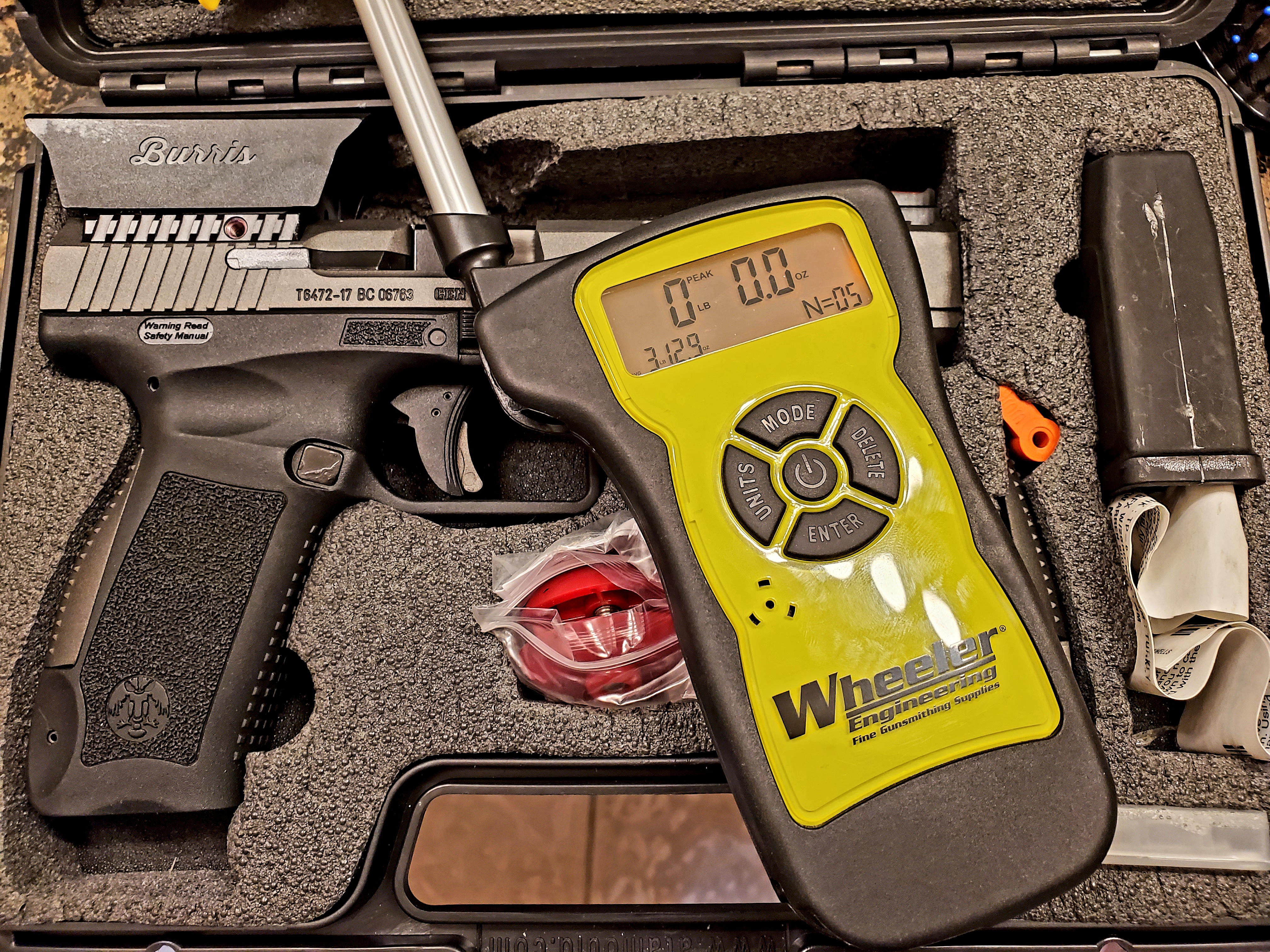

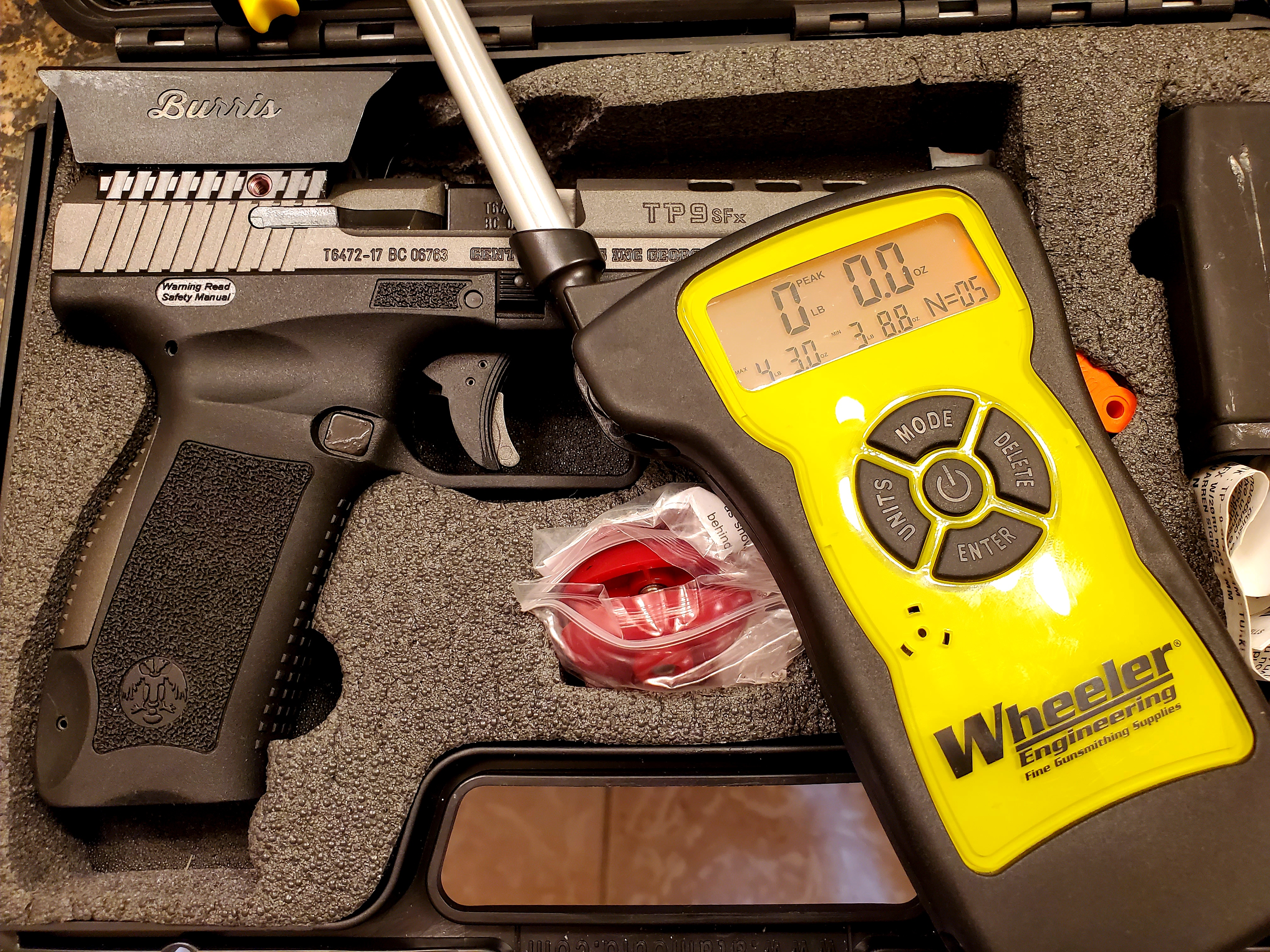

Here I tested the trigger pull on my TP9SFX
4 out of 5 less than 4lbs
Average 3lb 13oz

Definitely consistent with the other trigger gauge checks that I've seen in the reviews. In the installation video, they installed the Jefe in an SFx. I was a bit concerned at first because you can see how they provide the over-travel stop on the rear of the factory trigger. The Jefe is a bit different in its configuration, but I can not detect any over-travel. Then the reset is incredibly short, and I don't see how it could be any shorter for those who are concerned about reset. I found out everything I wanted to know with the 100 rounds I test fired, including the 19 +P level rounds I fired off at what I'd estimate as 2 rounds per second.

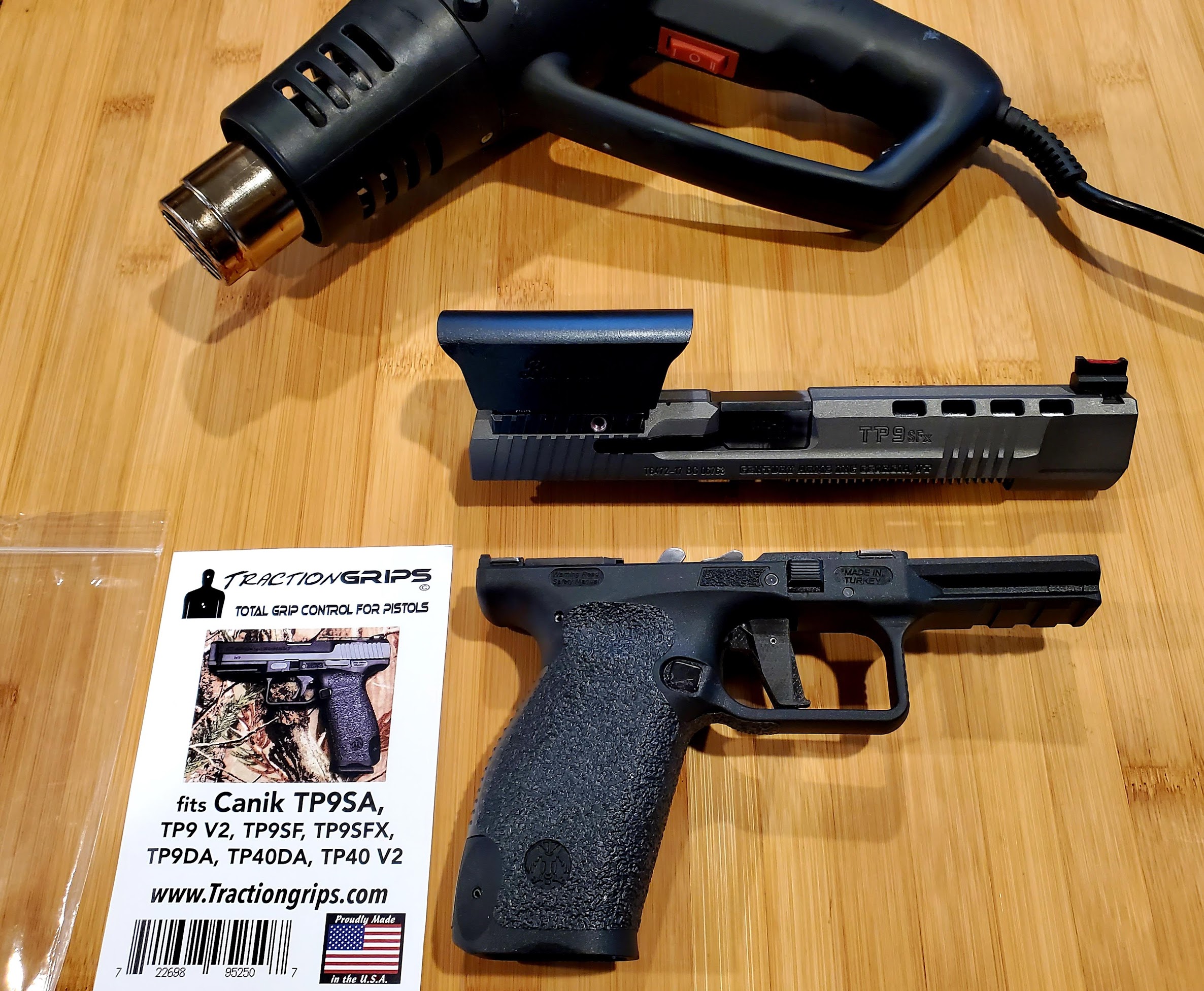

Friction tape added

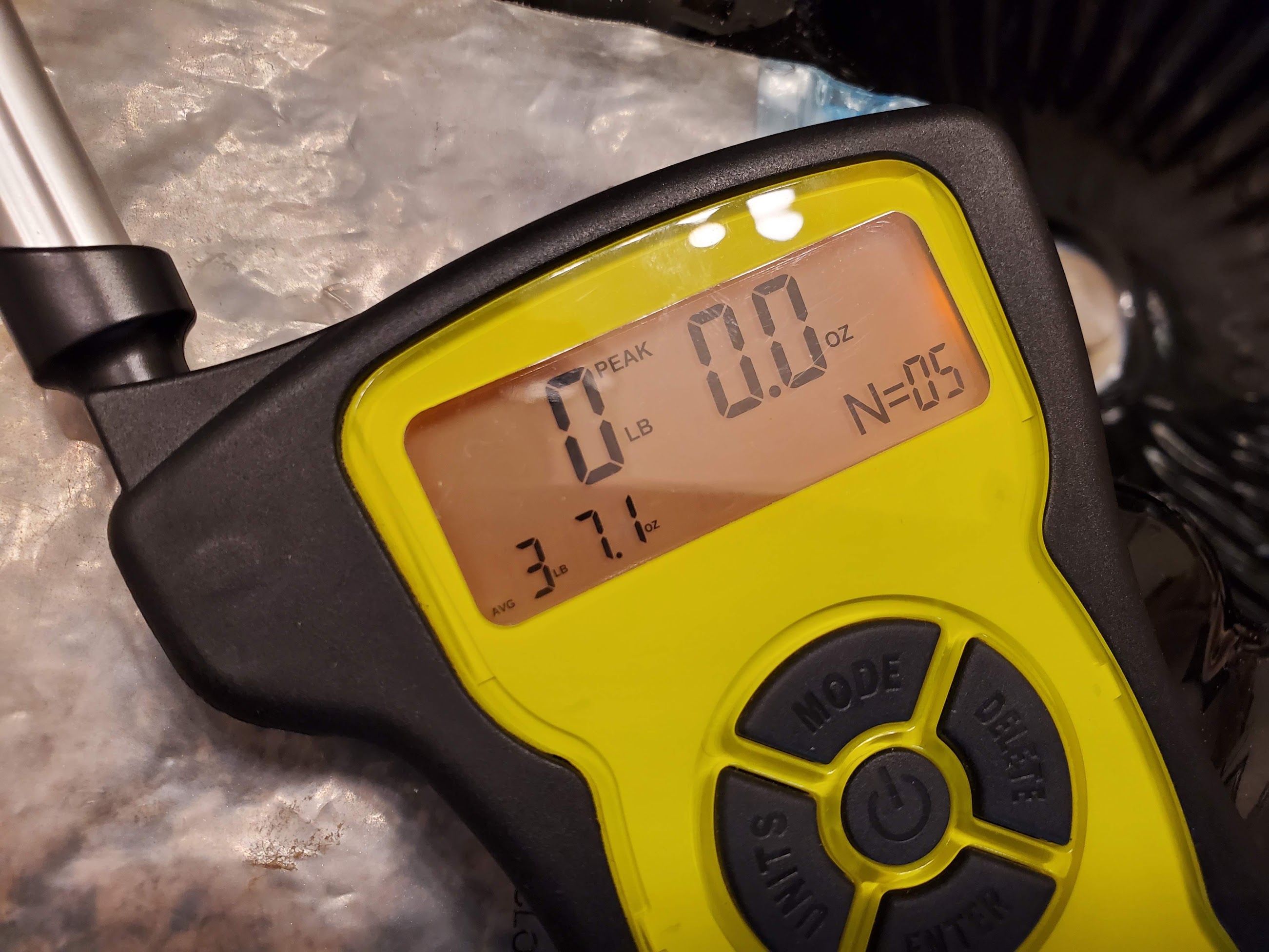

Post by Beiruty »
3.5lb pull weight
