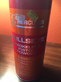

Posted this in another thread here, but ventured into the closet where all my reloading gear and supplies are kept to do an inventory of what I have on hand. Aside from the other surprises hidden away and forgotten was a box with some old cans of powder. Check out the price tag on the can in the pic for a trip back to the past...;) Also "discovered some other unopened cans of powder, a bunch of bullets and a couple K small and large pistol primers. Now to drag it out and figure out where to set it up, as I sold the old bench I used for reloading many moons ago......
