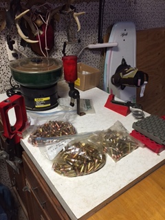

Slowly drifting back into reloading after moving a few years ago.
Made up about 400 rounds of 300 Blackout plinking ammo.
