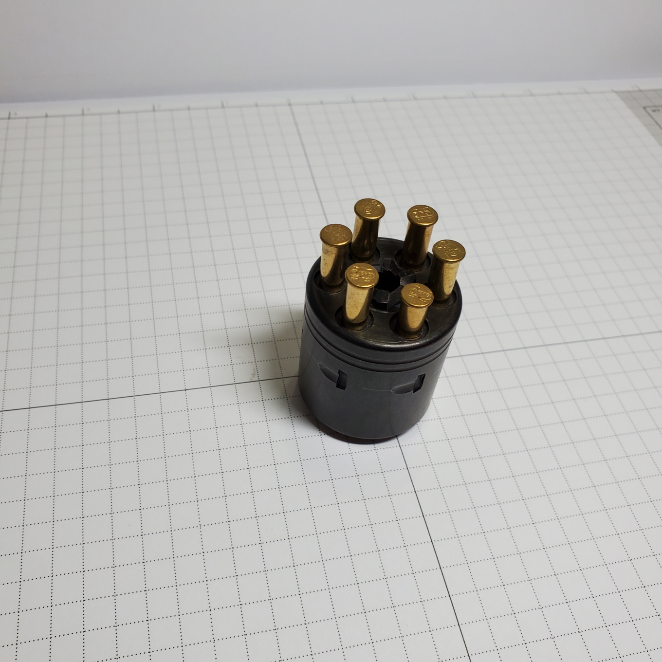

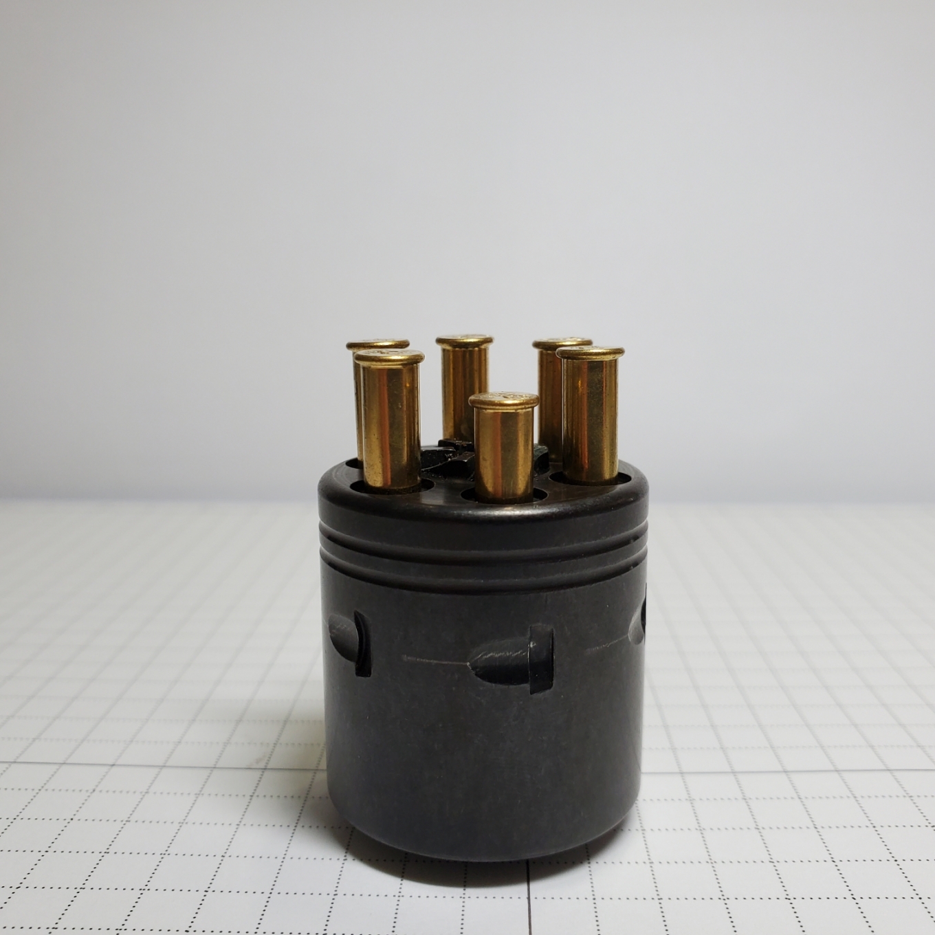

Ruger Customer Service wanted pictures to show the problem. Here are a couple with the Winchester ammo that won't drop into the cylinder.

I received the new cylinder from Ruger today, 25 May 2022. Happy to report that all ammo tried fit into each chamber just fine, though the Winchester was a slightly tighter fit than the rest. Still, it only took the littlest push to seat them fully, even the SuperX cartridges that wouldn't go in past the bullet in the other cylinder. I ran 12 rounds through it just to function check it, all fired just fine. Ruger customer service has come through again.
