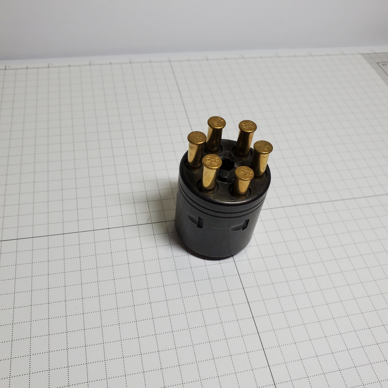

I bought a Ruger Wrangler budget-priced .22LR single action revolver this weekend, and despite the heat, wanted to put a few cylinders through it just as a function check.
I found out that Winchester branded .22LR ammo is WAY out of spec compared to pretty much every other brand that I have. There were multiple rounds of Super-X that refused to chamber, stopping at the case mouth. There were also multiple rounds of Winchester Western that did the same. Other brands tried were Remington, Aguila, Armscor, CCI, Federal, as well as Sellier and Bellot. All the others chambered easily, or with just the tiniest bit of push to seat them.
I also tried the Winchester in two other firearms, a Ruger SR22 and a Henry Lever Action, manually dropping/pushing the rounds into the chamber on both firearms. The Winchester did chamber in those firearms, but was a much more snug fit versus any of the others.
I looked around on the Net and found other folks making the same complaints about Ruger Wrangler and Single-Sixes in regards to Winchester ammunition. Have any of y'all seen this before? If you have, please share any info you may have on the subject. Thanks.

Ruger Customer Service wanted pictures to show the problem. Here are a couple with the Winchester ammo that won't drop into the cylinder.

UPDATE:
Ruger Customer Service looked at the pictures I sent, and are shipping me a new cylinder. I'll add to this particular reply when I receive it and test it out.
EDITED TO ADD:
I received the new cylinder from Ruger today, 25 May 2022. Happy to report that all ammo tried fit into each chamber just fine, though the Winchester was a slightly tighter fit than the rest. Still, it only took the littlest push to seat them fully, even the SuperX cartridges that wouldn't go in past the bullet in the other cylinder. I ran 12 rounds through it just to function check it, all fired just fine. Ruger customer service has come through again.
